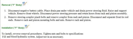

How do I replace? I cant get drivers side bolt out.
