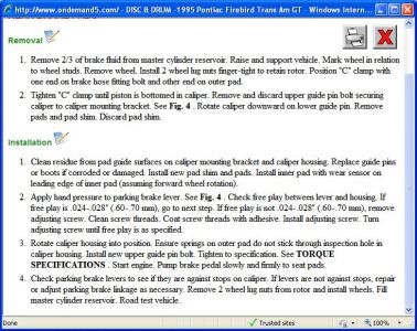

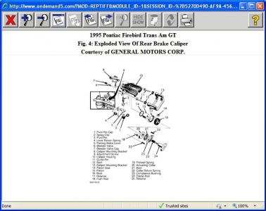

Do i need to screw the piston in the caliper,in for the emergency brake to change pads. or will it just go in with pressure. The old 79's you had to have a special wrench to turn them in

There's the info you need.
