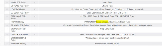

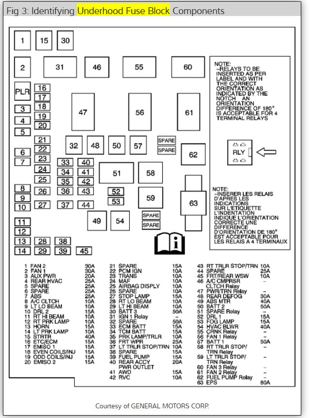

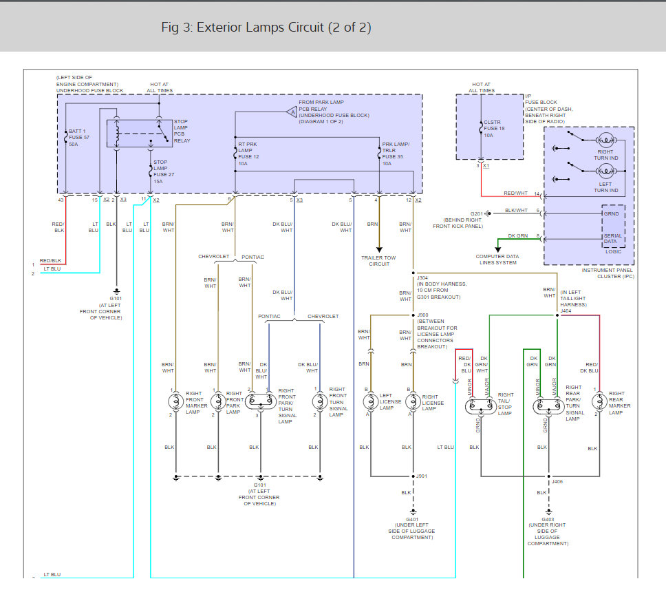

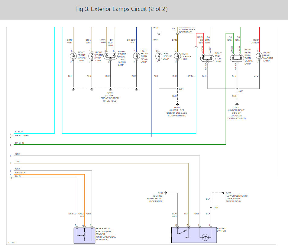

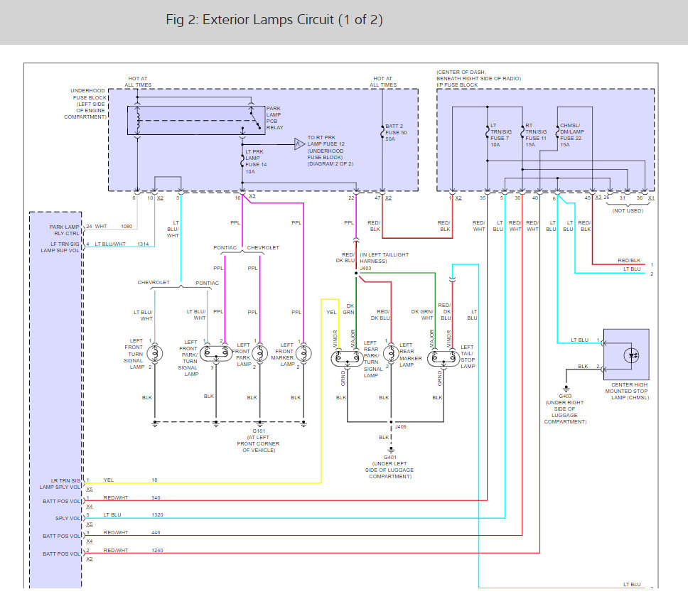

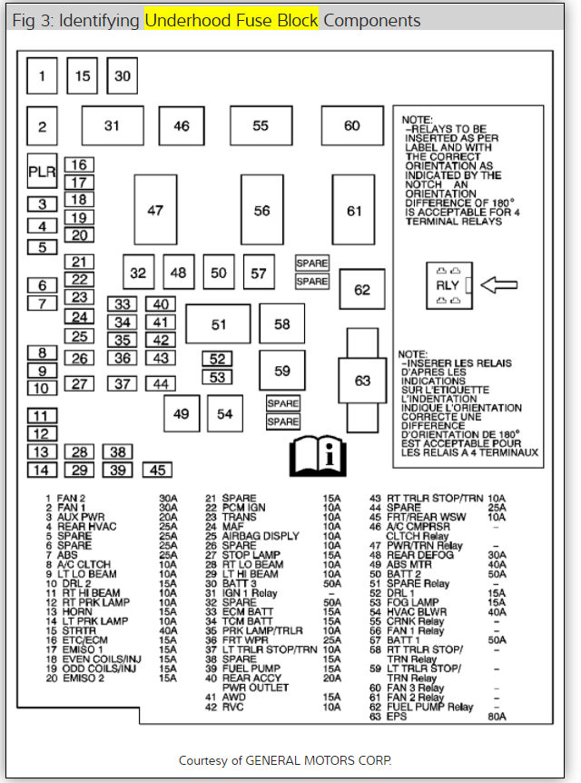

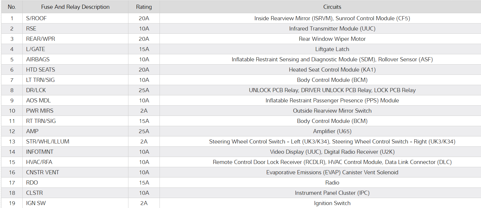

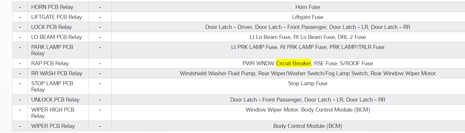

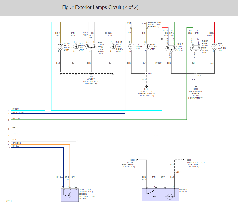

There is a stop lamp relay that goes out on these cars but to be sure lets run this test.

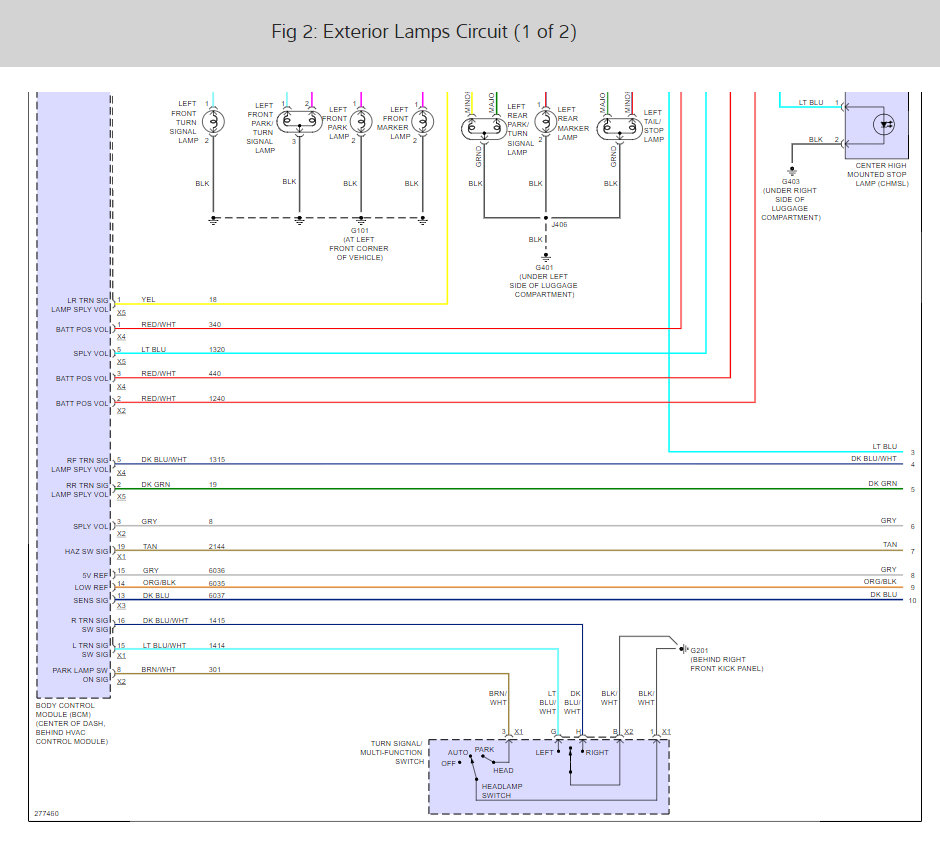

Here are the brake light wiring diagrams so you can see how the power is routed when you hit the brakes.

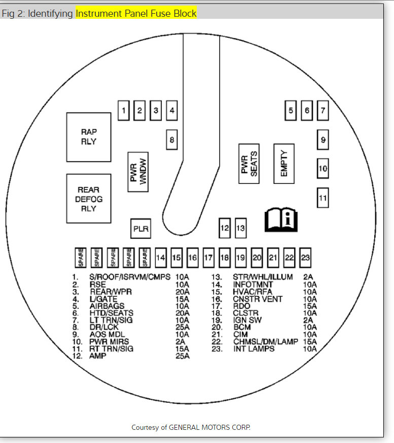

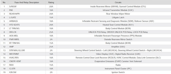

See where you lose power. Here are the fuse panel and relay locations for your car save this page in your favorites for future reference.
Cheers

i checked the fuses and nothing.. the third break light works but the two tail light brake lights do not work when i push in the brakes. the work with everything else tho.. what is causing this?
Sep 15, 2009 at 5:28 AM
JDL
  • 16,098 POSTS
If your saying there is no voltage at the stop lamp fuse, then check the circuits at the stop lamp relay.
Sep 15, 2009 at 8:50 AM
GHENGIS1210
i am having the exact same problem with a 2006 torrent...the fuses are okay so I replaced the relay and its all fixed! ...totally helped
Mar 19, 2010 at 2:31 AM
JEWEL942

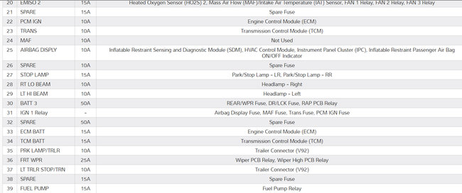

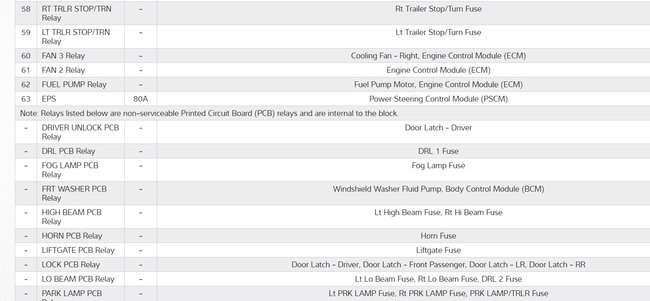

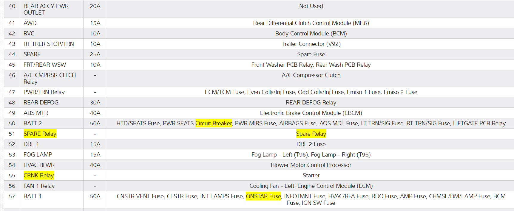

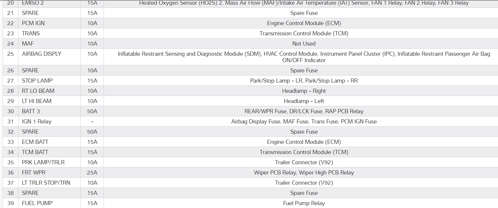

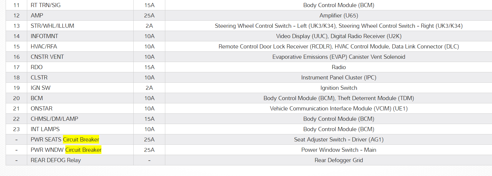

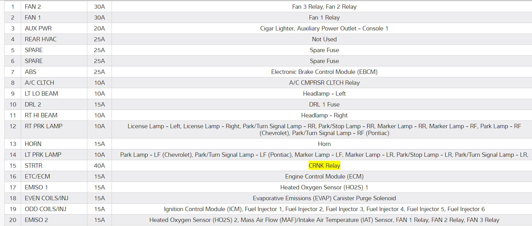

What number on the fuse block is the brake light relay? I see #27 is the fuse... thanks.
Feb 4, 2019 at 11:42 PM

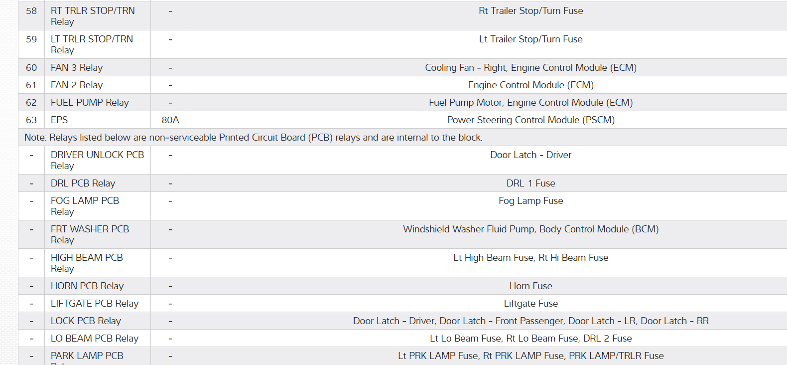

  • 55,561 POSTS
It looks like 58 and 59 are the stop relays for the trailer this must be for the tow package. See if the both relays click when you press the brake pedal.
Feb 5, 2019 at 3:14 AM
JEWEL942

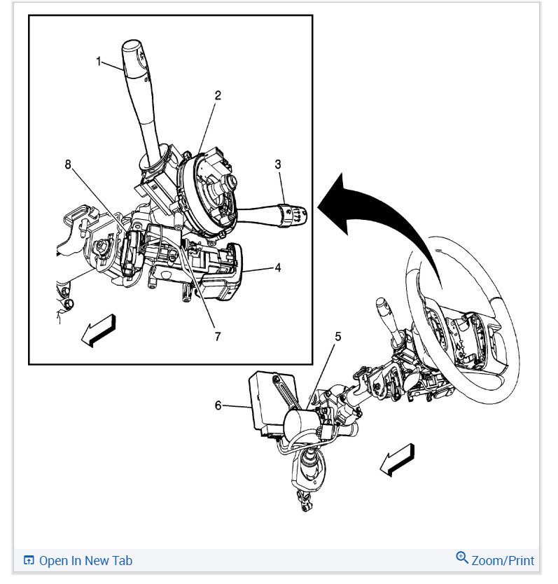

I'll check those but (1) I don't think this has tow package, and (2) both lights go out at the same time, while these relays each cover only one side of the car.

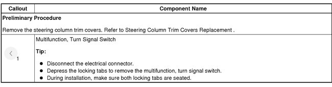

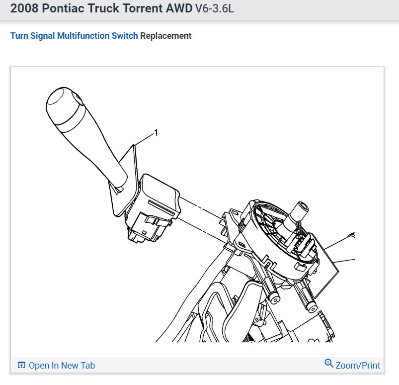

Another thread I saw mentioned the multi-function switch is sometimes at fault, the wiring is tied into this switch as the brake light circuit is cut on the side of a turn signal. Given that I occasionally lose headlights when using my brights flasher, I'm going to go ahead and replace that - hopefully will solve both problems.
Feb 5, 2019 at 3:26 AM
  • 55,561 POSTS

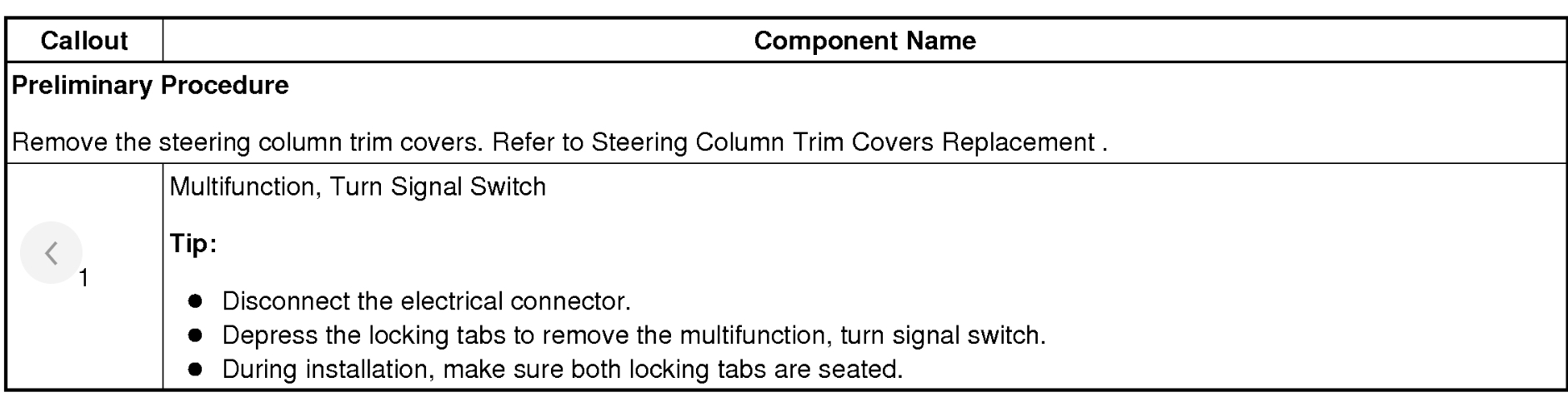

Good call, here are instructions and diagrams to help you change the switch out. Check out the diagrams (below). Please let us know what happens.
