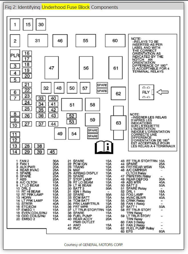

My power outlet (used to be the cigarette lighter) has quit working and I'm trying to figure out which fuse I need to check. Can you help?
Aug 16, 2009 at 12:46 PM
  • 55,423 POSTS

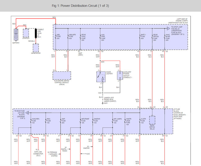

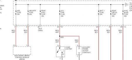

Hello, The fuse you are looking for is the AUX fuse int he main fuse panel under the hood. Fuse powers both the cigar lighter and the auxiliary power outlet console. Here is a small wiring diagram of the circuit a larger one is below along with the guide to help you test it. https://www.2carpros.com/articles/how-to-check-a-car-fuse
