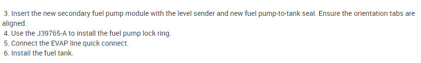

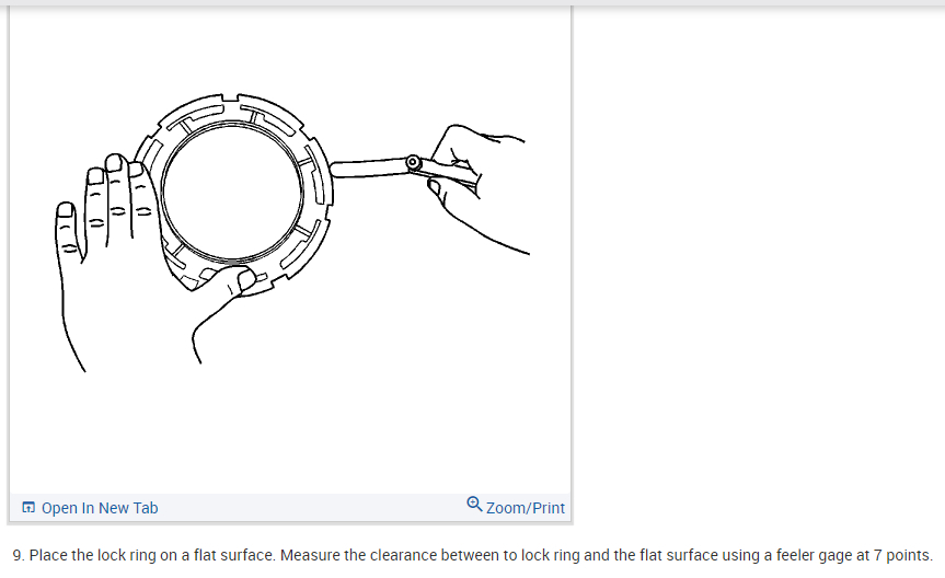

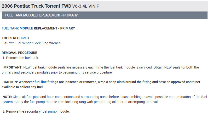

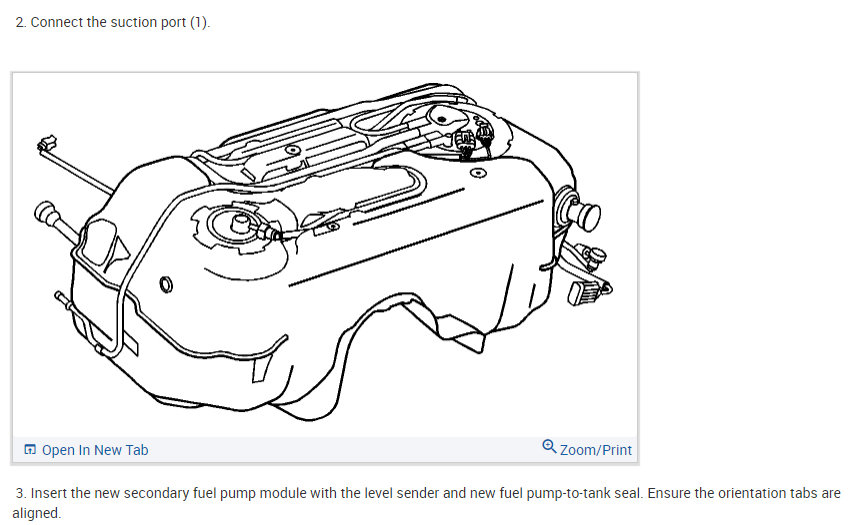

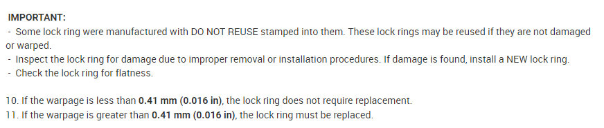

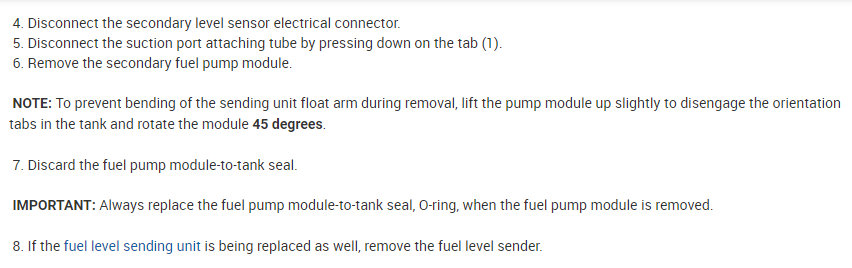

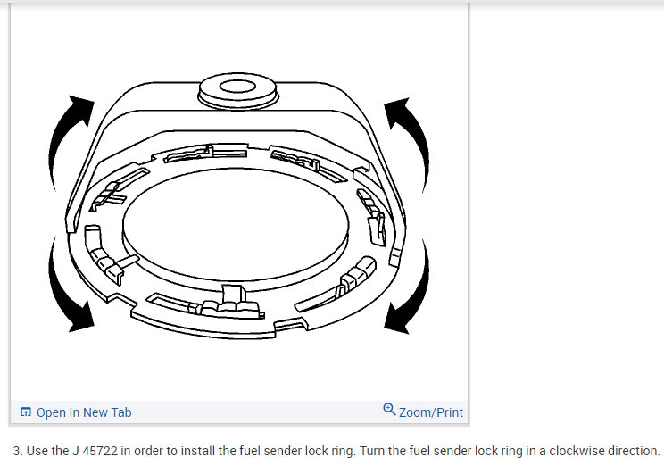

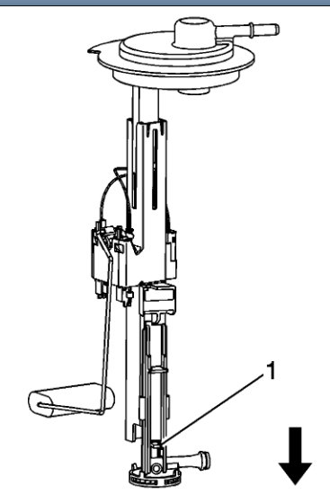

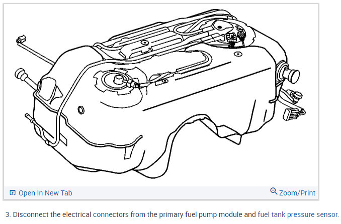

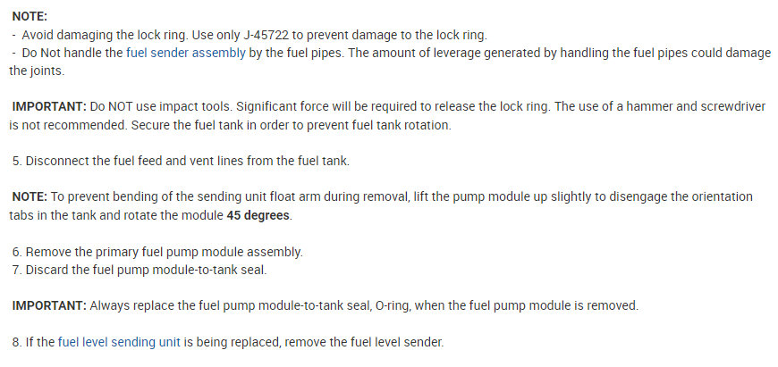

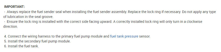

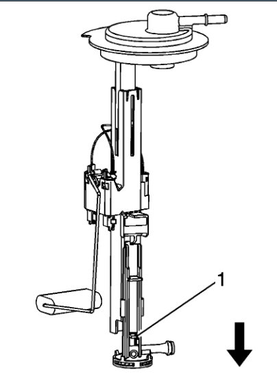

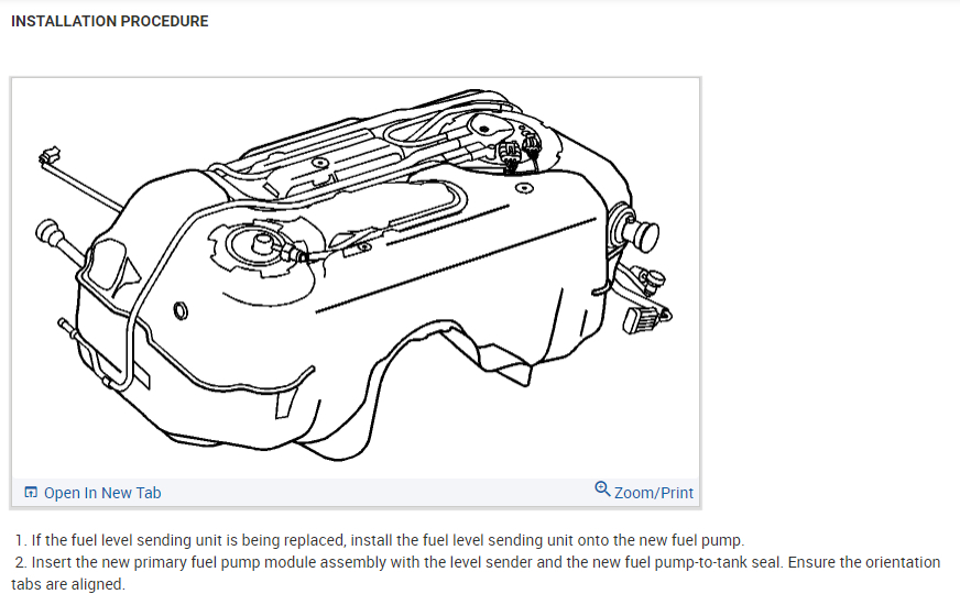

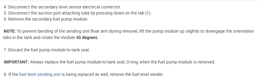

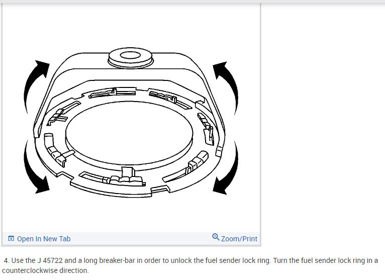

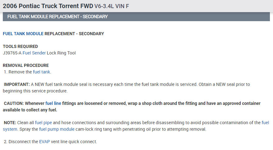

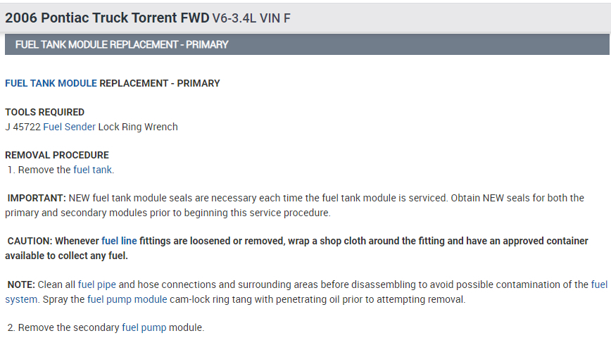

Here is the information you requested. Here is a tutorial for you to view on how to test fuel pressure and replace an in-tank electric fuel pump:
https://www.2carpros.com/articles/how-to-replace-an-electric-fuel-pump
The fuel pressure specification for your vehicle is with key on-engine off is 50-60 PSI.
I've attached picture steps below on how to remove and replace the in-tank fuel pump for your car. Hope this helps and thanks for using 2CarPros.
