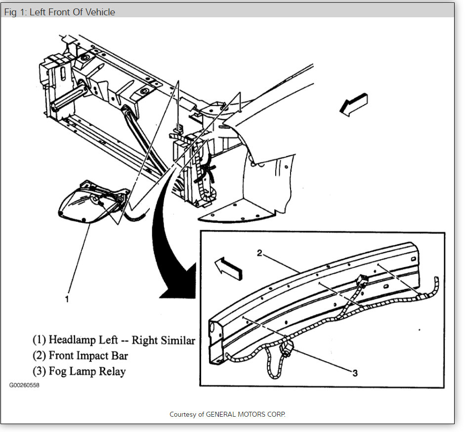

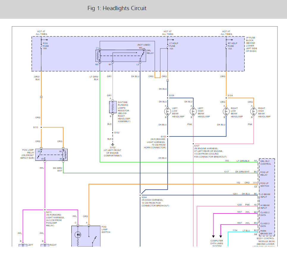

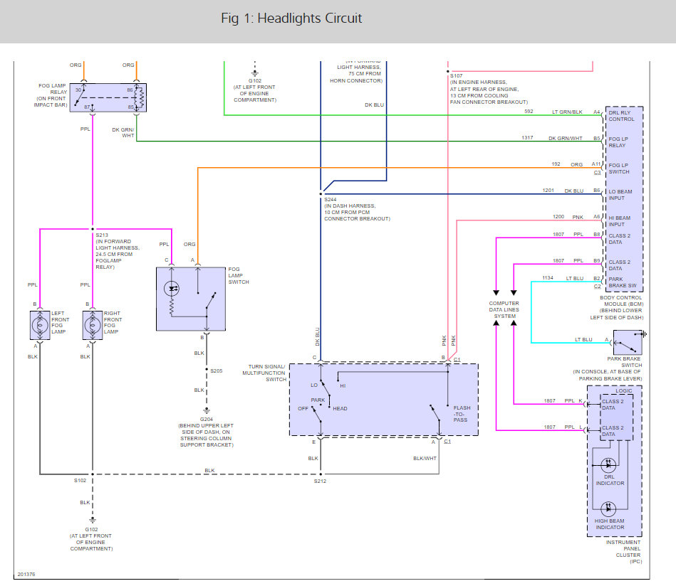

The fog lamps on my 2005 Sunfire suddenly stopped working. I have checked both bulbs and they are fine. I have tested the switch, and checked the fuse, both are working. The problem is that when I go to turn on the fog lights, the indicator light on the switch does not turn on, nor do the fog lamps. I know power is getting to the switch, (checked it with a volt meter), is there another relay or fuse that may be the problem? If so where would it be located at?
Thank you for any help.
Nov 9, 2009 at 6:14 AM
  • 55,684 POSTS
It sounds like you have a fog light relay that is not working but to be sure here is a guide to help you test it.
The location of the relay is in the front near the bumper here is a guide gram of the fog light wiring and the fog light relay location.
See where you are loosing power.
