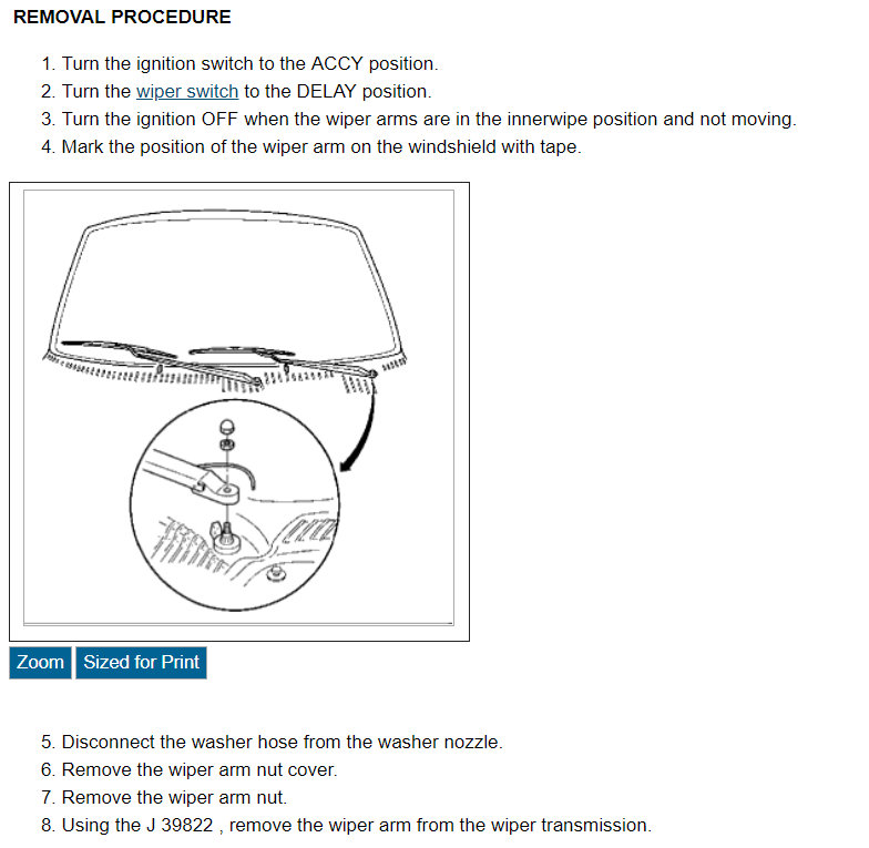

How do you replace a driver side wiper arm?
Oct 31, 2010 at 9:56 PM
MMPRINCE4000
  • 8,548 POSTS
Install the nut so it covers the threads and then apply pressure upward on the arm, take a hammer and lighting tap the nut and pivot downward it should pop off it is tapper fit.
