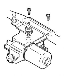

The other day driving in the rain my passenger side wiper stopped working. Once it stopped raining i went out to look at it and it was very loose and free, I could move it myself. So I thought it just needed tightening but the nut was very tight. So i then removed the black cover and I noticed rod that connects the wipers to the wiper motor was not attached anymore. I tried to see if a nut came off but there is not a bolt or a nut that connects it. Is there anyway to fix this?

Pushing it in back will not resolve the problem for long it will come apart again.
best way to deal with it is to have the wiper transmission replaced. you are half way there.
need more directions let us know.

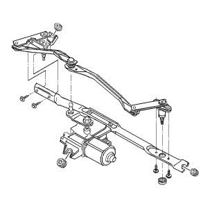

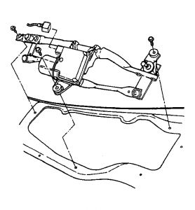

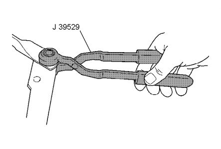

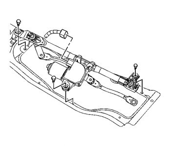

You can try to put it back together for time being and if you like, but I have seen it come apart very easy after that and I do not believe it safe (specially in a snow storm ).
https://images.2carpros.com/forum/automotive_pictures/99387_Graphic5_7.jpg
or replace the transmission.
https://images.2carpros.com/forum/automotive_pictures/99387_Graphic1_134.jpg
https://images.2carpros.com/forum/automotive_pictures/99387_Graphic2_70.jpg
https://images.2carpros.com/forum/automotive_pictures/99387_Graphic3_33.jpg
https://images.2carpros.com/forum/automotive_pictures/99387_Graphic4_17.jpg
