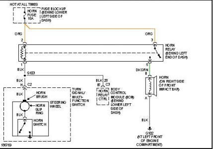

2004 Pontiac Sunfire horn stopped working, have changed fue
2004 PONTIAC SUNFIRE
122,000 MILES • 6 CYL • 2WD • MANUAL
NEWZAL
have changed the fues but the horn still not working

Hi, the problem is usually in the steering column, but, you can check the horn circuits. Any time you check a fuse, use a testlite, that way you'll know the circuit is hot.
https://images.2carpros.com/forum/automotive_pictures/170934_sunfire_horn_1.jpg
