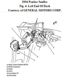

Where is the horn relay located on the 2004 Sunfire? The horn is inop, fuse is good.
Mar 27, 2009 at 5:58 AM
BLUELIGHTNIN6
  • 16,542 POSTS
Horn relay is located behind left end of dash, pictured below..
