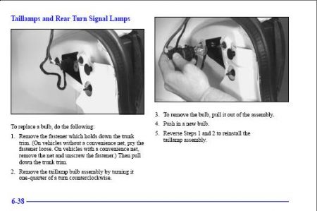

I need to know how to change the rear turn signal bulb. I'm not sure what I'm doing and I would like some info before I attempt and screw something up.

Welcome to the forum. I found this info in your owners manual.
https://images.2carpros.com/forum/automotive_pictures/170934_sunfire_turn_signal_1.jpg
