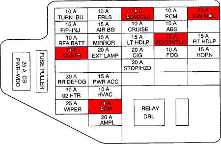

Hello there,
I was to "re-arrange" wires behind the CD player (aftermarket) and unfortunately the red one (ACC?) and the yellow one (15A Battery) got in touch.
Result ... I can not start the engine any more.
When the key is in the ignition position it only lights the Theft System and the amber one from the engine. When I release the key to the running position all lights are on again and turn off afterward.
The Theft System in not flashing like most people say.
thank you,
Feb 28, 2009 at 4:17 PM
ZACKMAN
  • 4,202 POSTS
You may have blown one ore more fuses. Locate your fuse box, under driver side dash. And check every single fuse. Pull them out, one at a time, and check to make sure they are still good. Keep special attention to the highlighted ones.
