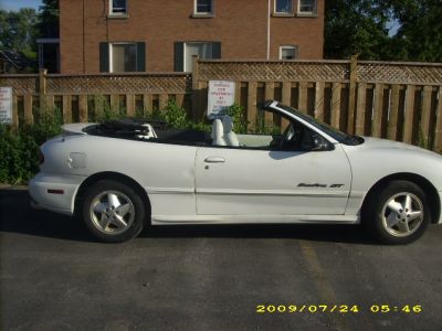

hi..i had to slam my brakes on hard when a car pulled out in front of me, i was driving in 5th gear when it happened, now i cannot press o my brakes as there is a very bad clunking, it sounds like it is under the pedals, i am so scared,do you have any idea what it might be....thankyou hope to hear from you soon this is an emegengy[img:0cd4a05a8b]http://www.2carpros.com/forum/automotive_pictures/461941_wedding_and_misalaneous_189_1.jpg[/img:0cd4a05a8b]
