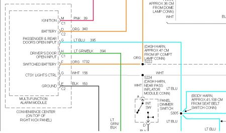

cannot get the interior dome light, rear view mirror map lights and trunk light , and power mirrors to work. Rest of functions on the fuse works such as warning chimes, radio, and keyless entry. Is there one wire that feeds just the lights?

Did you check this fuse for voltage? Use a voltage tester. In the other diagram, the top orange wire voltage from the fuse I mentioned. The lower orange wire is voltage to the dome light. Also, ground could be an issue?
