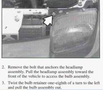

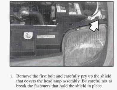

Im trying to change a headlight on my 98 sunfire. Can you give me any instruction on the procedure for this car. Does the lense come off the front or do i have to change them from underneath?

Welcome, found this info in your owners manual.
https://images.2carpros.com/forum/automotive_pictures/170934_headlamp_assembly_1_1.jpg
https://images.2carpros.com/forum/automotive_pictures/170934_headlamp_assembly_11_1.jpg
