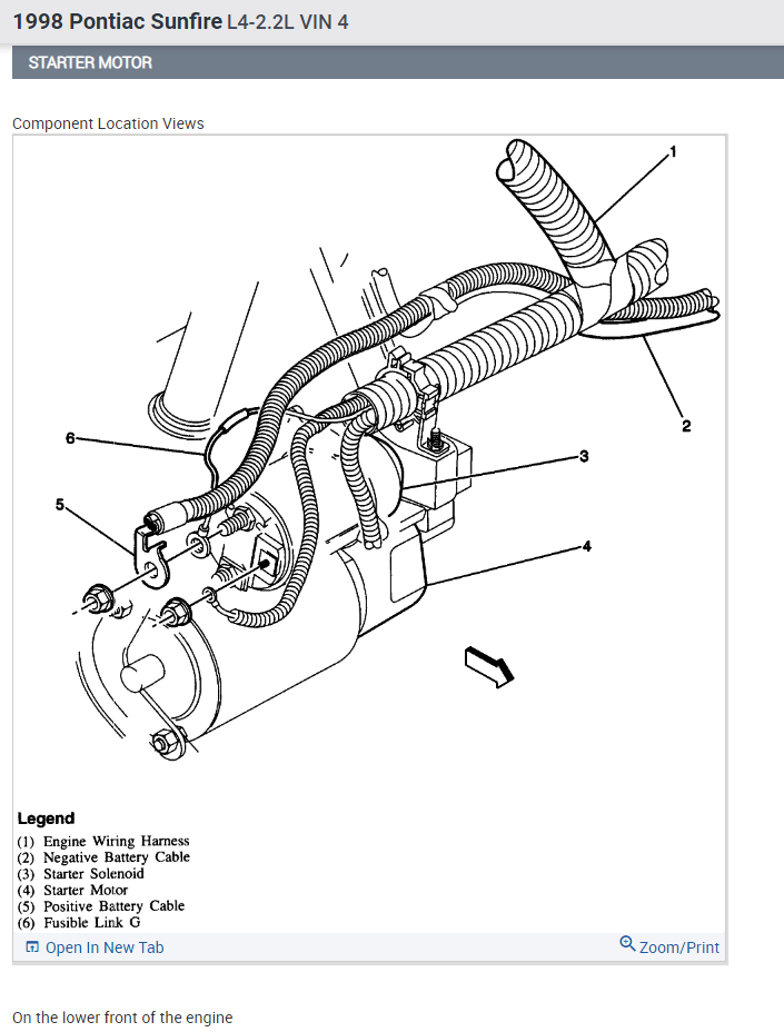

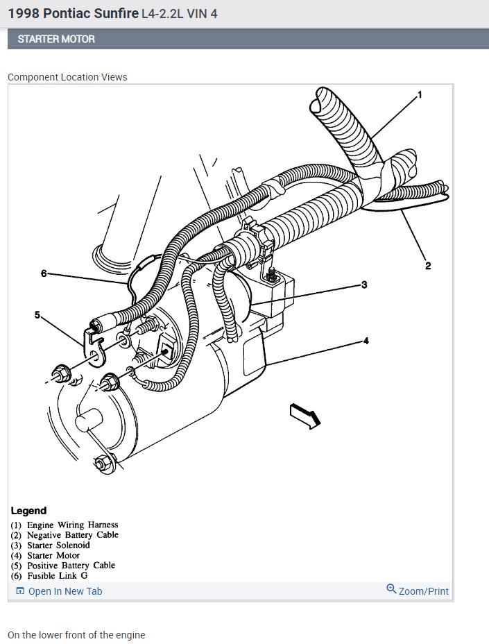

If you are unable to jump start it and the car just 'clicks' then it could be the starter or the wires that goes to the starter. Make sure those wires are connected securely and free of corrosion.

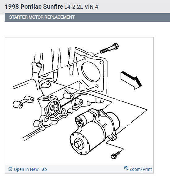

The starter is located on the lower front of the engine
https://www.2carpros.com/articles/how-a-starter-and-solenoid-works
