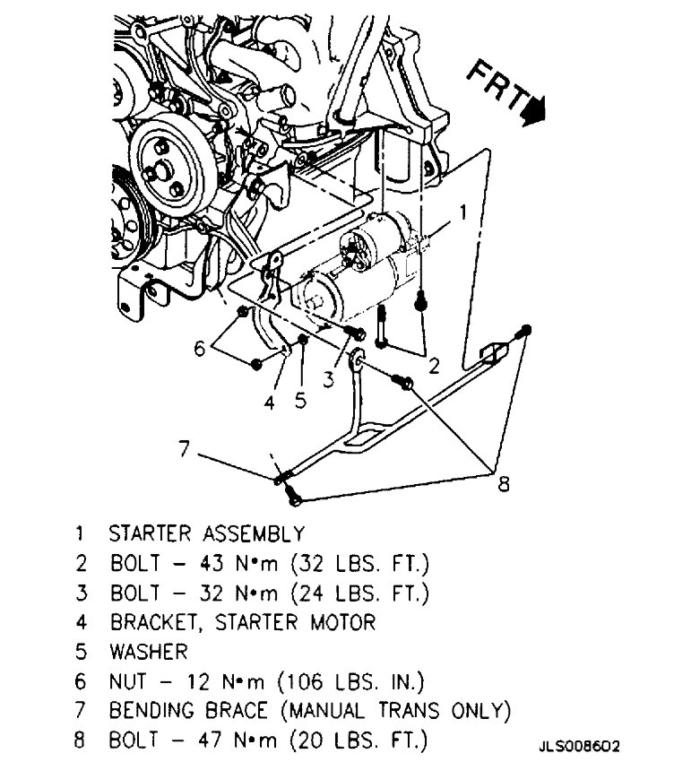

What wires go where on the starter solenoid?
May 22, 2010 at 10:15 AM
Experienced Mechanic
75,988 POSTS
Hi kennykbt1961, Welcome to 2carpros
Here is a guide that will walk you through the starter wiring and how they go on the solenoid.
Image (Click to enlarge)
Professional Diagram for 2CarPros Members
Click here to log in and view diagram.
