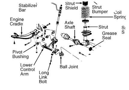

i was wondering if anyone could tell what i have to take off to change the passenger side lower control arm bushings. i've got the wheel off and need a little guidance. Any help will be appreciated?

lower control arm need to come off As you see in the pic remove lower ball joint nut remove stabilizer link long bolt remove lower control arm bolts
