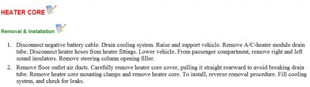

Heater problem
1997 Pontiac Sunfire Manual
How do i replace the heater coil.

https://images.2carpros.com/forum/automotive_pictures/261618_Noname_2729.jpg
