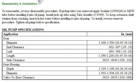

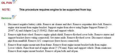

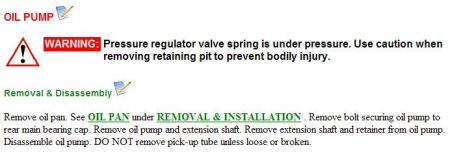

i am trying to get to oil pump to put in a new one. my question is, the bolts at the front of the pan. how do i get to them,do i have to take that big brace off from the frame that craddles the pan and if so.any instructions... i am deeply in your debt.... thank you in advance.....hopefull for a helping reply

https://images.2carpros.com/forum/automotive_pictures/261618_Noname_409.jpg
https://images.2carpros.com/forum/automotive_pictures/261618_3_10.jpg
https://images.2carpros.com/forum/automotive_pictures/261618_Noname2_113.jpg
