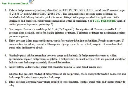

hello im just courious how i can check the fuel pressure on my sunfire. i suspect that the fuel pump is going out. but i wanted to make sure before i just started throwing parts at it. i know its suppose to carry like 41 psi.

https://images.2carpros.com/forum/automotive_pictures/261618_Noname_1500.jpg
https://images.2carpros.com/forum/automotive_pictures/261618_Noname2_445.jpg
