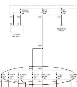

i need to know what the battery maxi fuses powers ,the fuse is under the hood there are 2 of them both are 40 amp.i have a draw and it is on the maxi fuse that works the headlights ,

Are you talking about the bat 1 fuse? The fuses in the circle, pull them one at a time.
