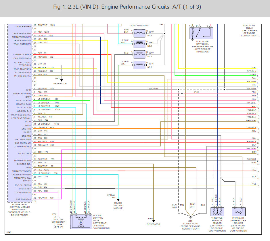

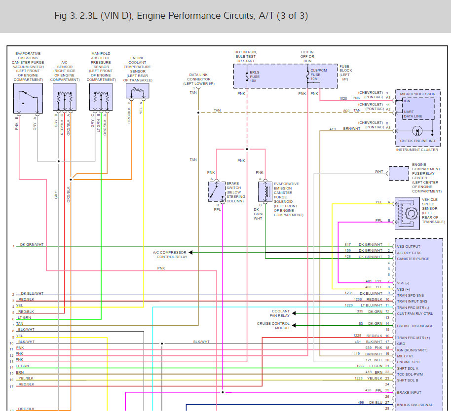

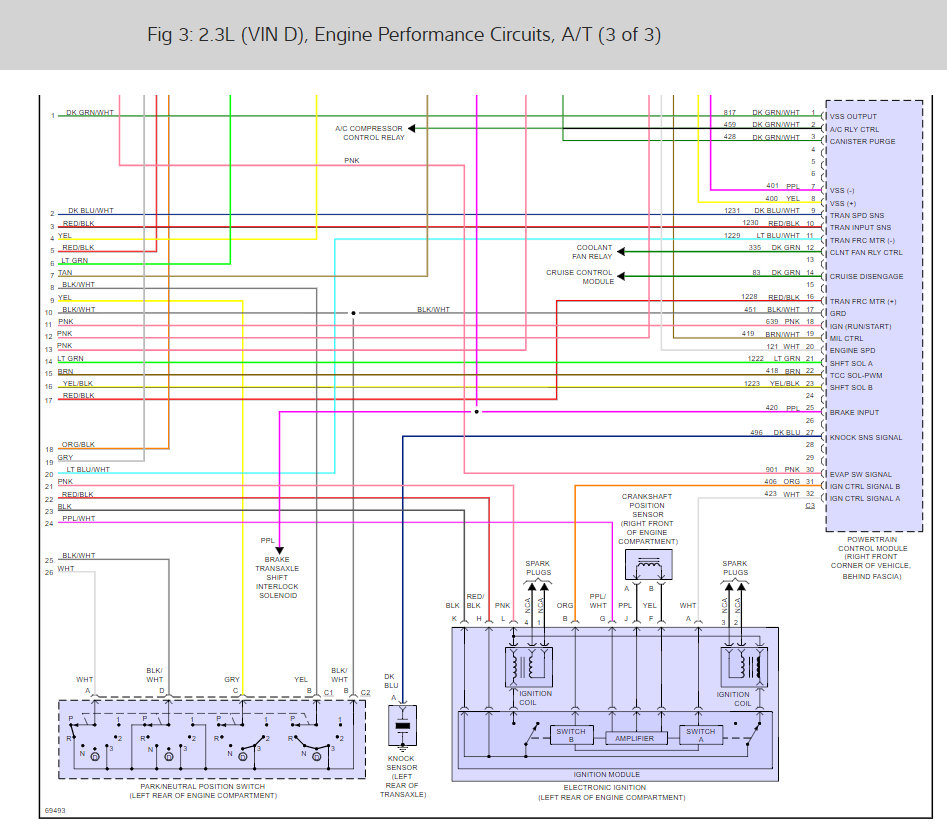

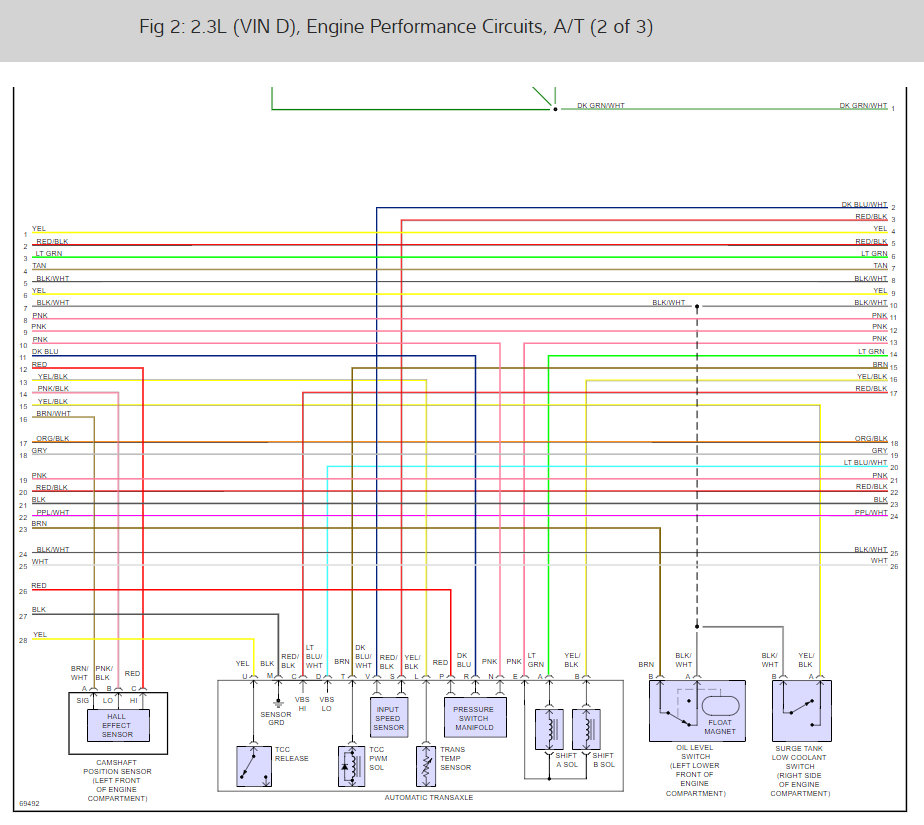

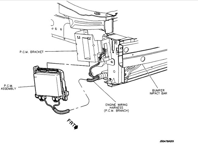

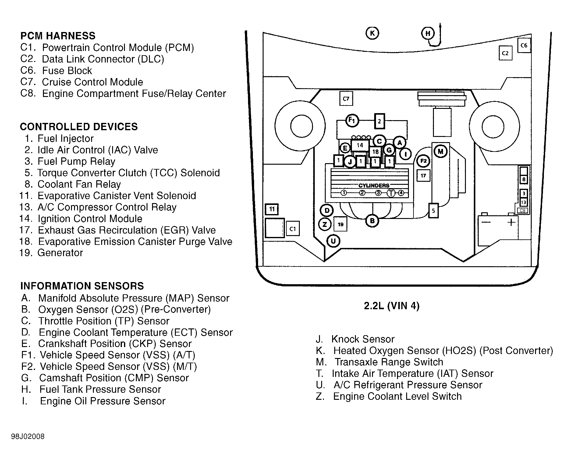

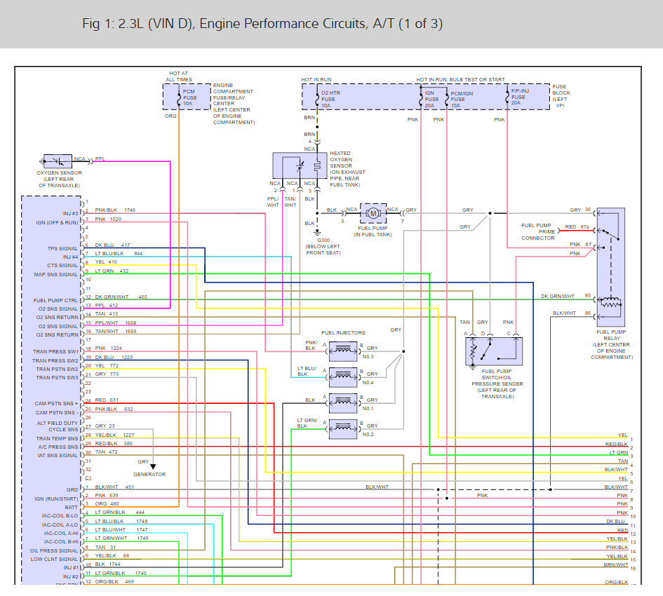

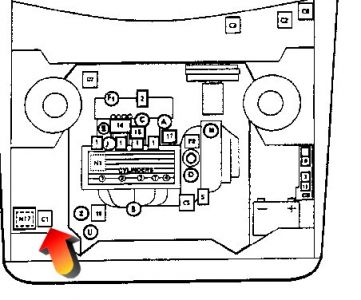

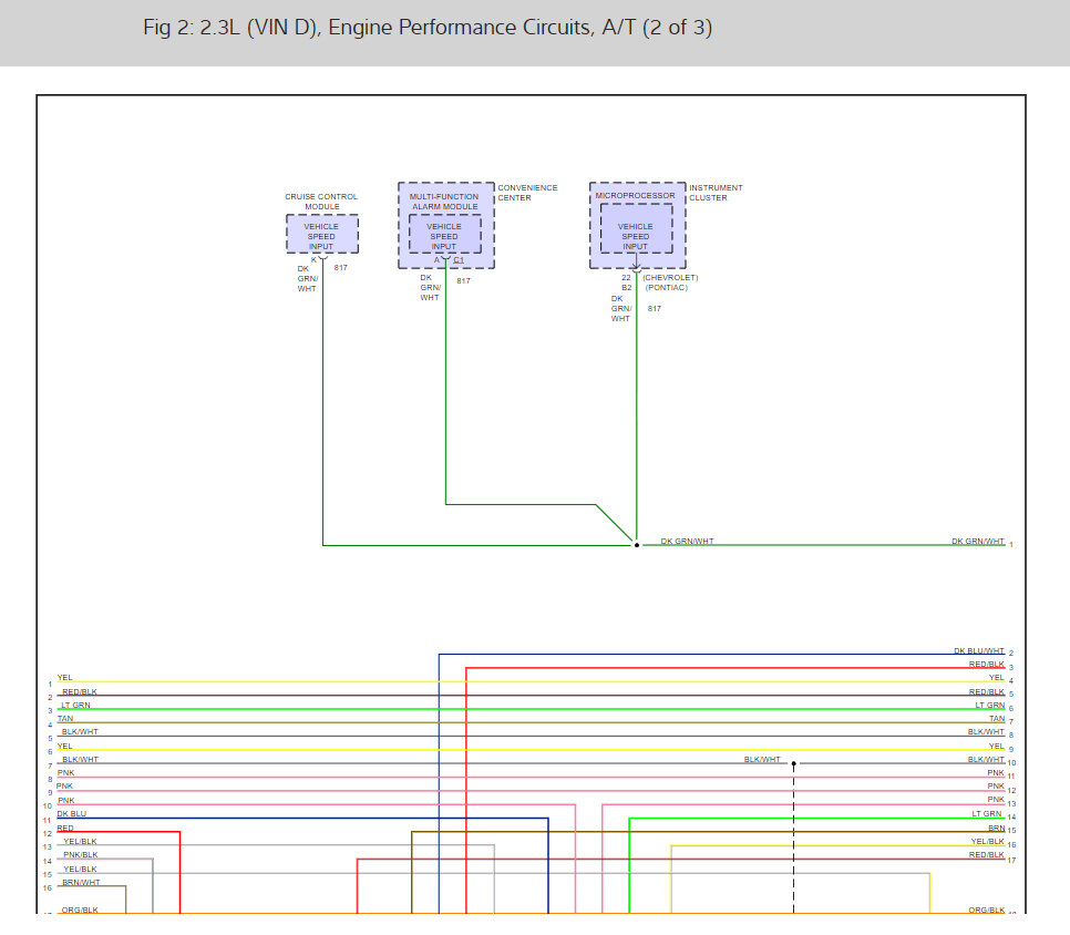

The engine computer or ECM is located in front on the right side near the frame rail. Here is a diagram of its location (below) Here is the engine and ECM wiring diagrams so you can check the power and ground circuits.

They moved it to the right front fender area. Don't be surprized if the pcm is split open. The dealer has a sheild that was later developed to protect the pcm from water intrusion.

hello. I had the same issue. the computer is now located under the front right fender. look under your car about a foot from your wheel. you should see it there.

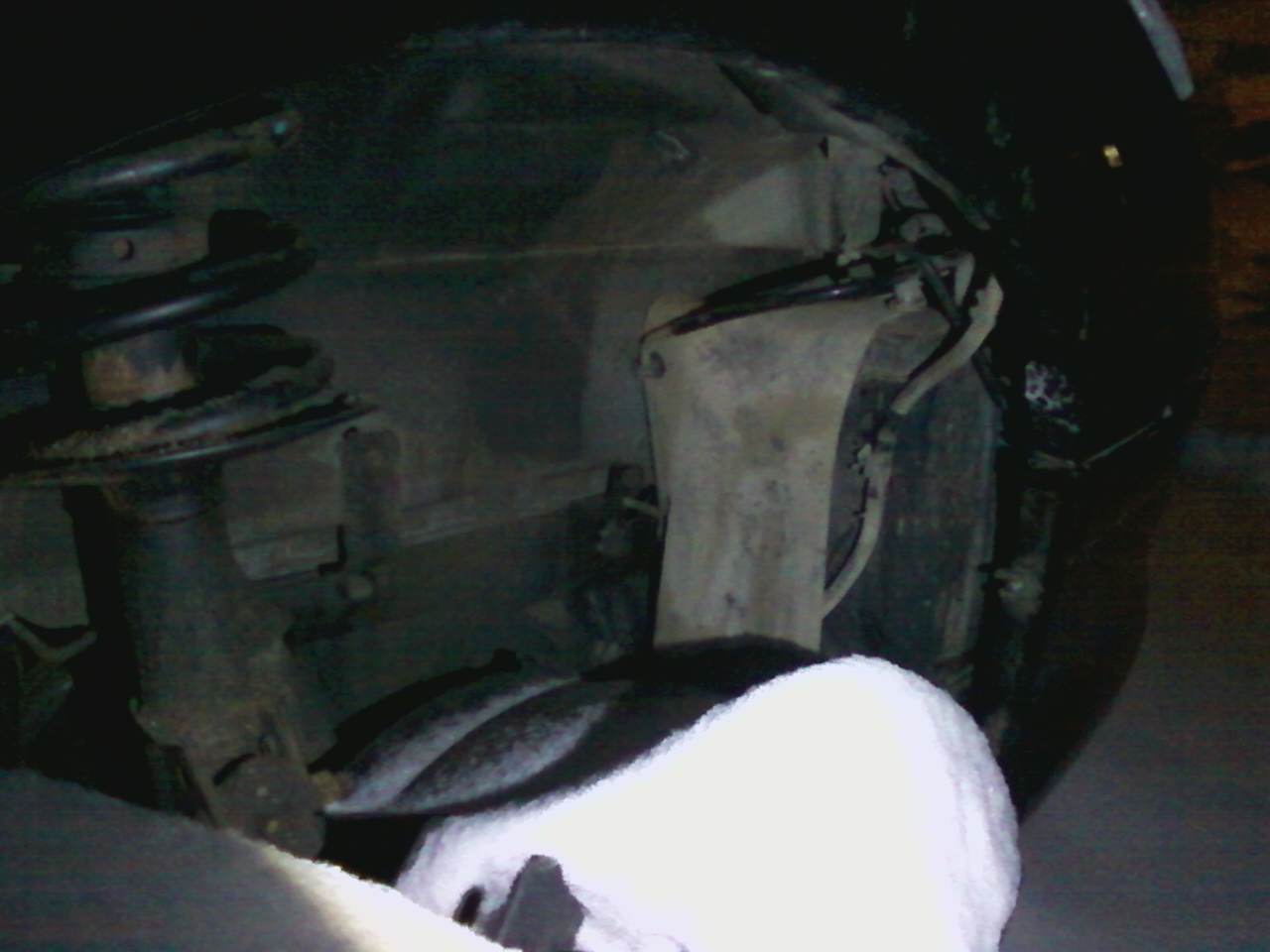

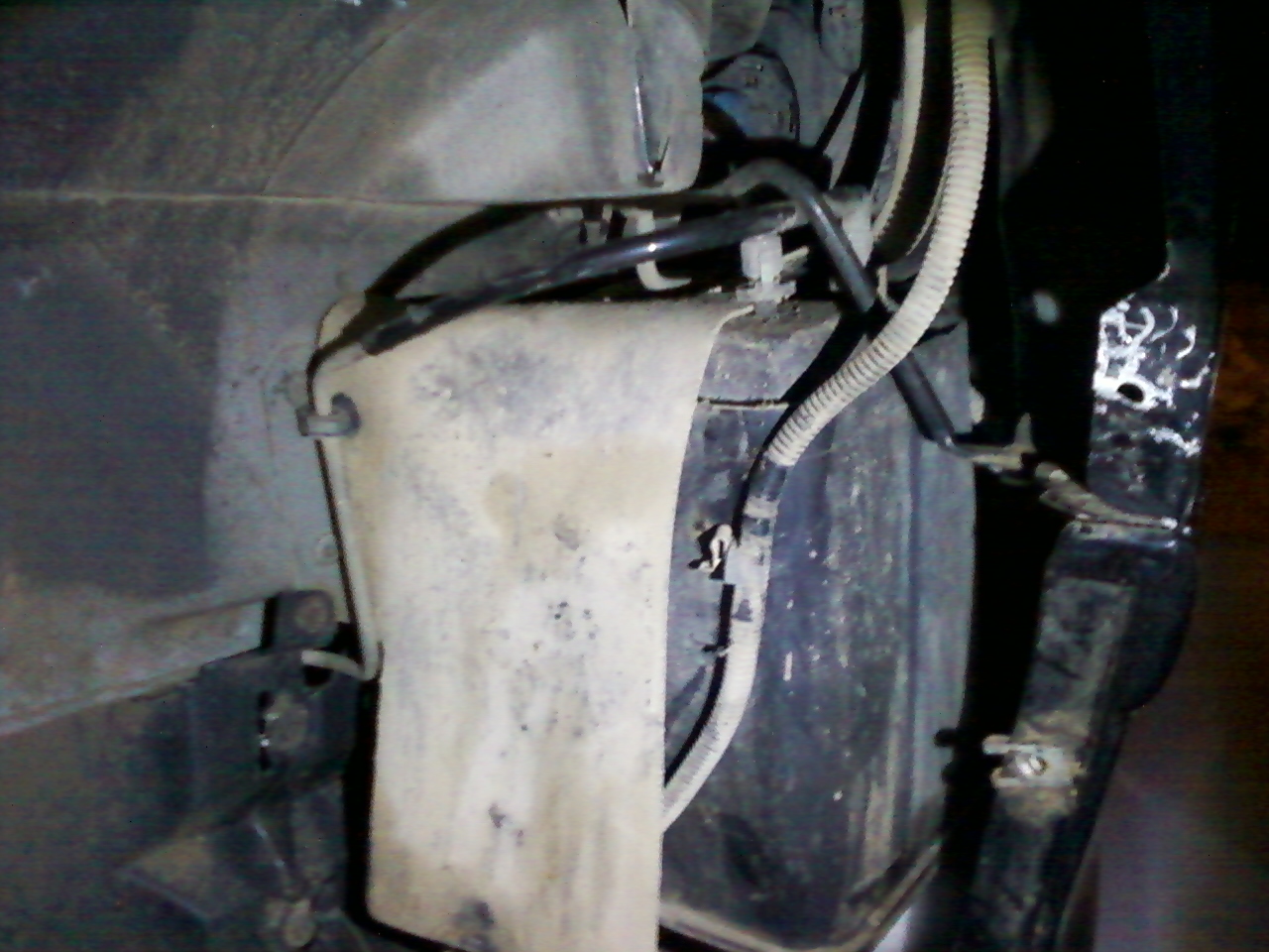

I need to know if this is indeed where the computer is located in my 96 sunfire before I pull it out.
Pictures were taken in the passenger side wheel well after removing the splash gaurd
Also what do I need to do when I put the new/used one in?
Nov 10, 2017 at 4:35 AM (Merged)
WRENCHTECH
  • 20,761 POSTS
No, that is certainly not the computer. That is the fuel vapor canister. It has fuel lines going to it, not wires as the computer would have.
It appears that it's behind the right front bumper which is a pretty unusual place for it to be.

They put it in the right front fender area in front of the wheel. Dumb spot, lots o problems from this. They did issue a bullitin for a protective cover.

It's At the right front corner, behind the fascia.
