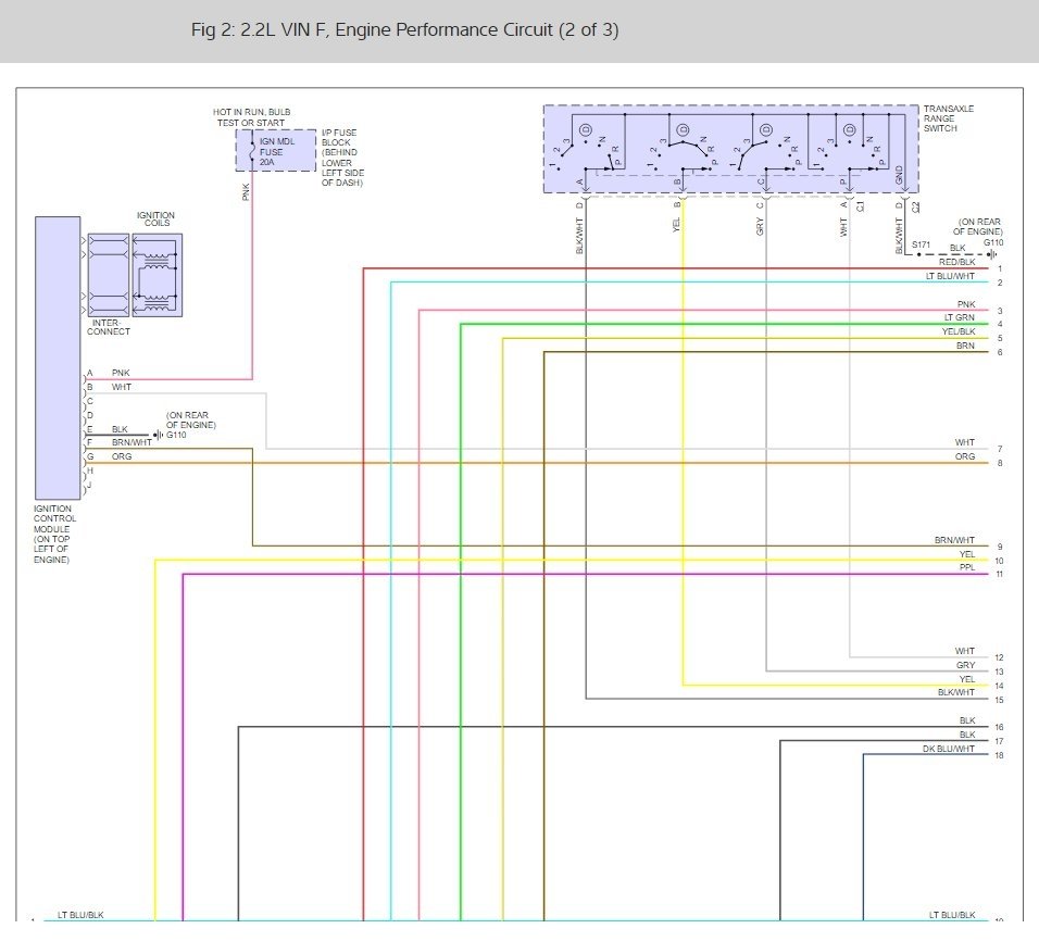

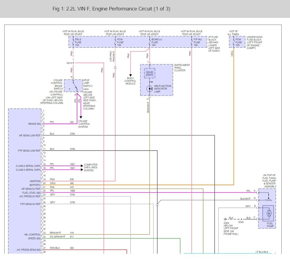

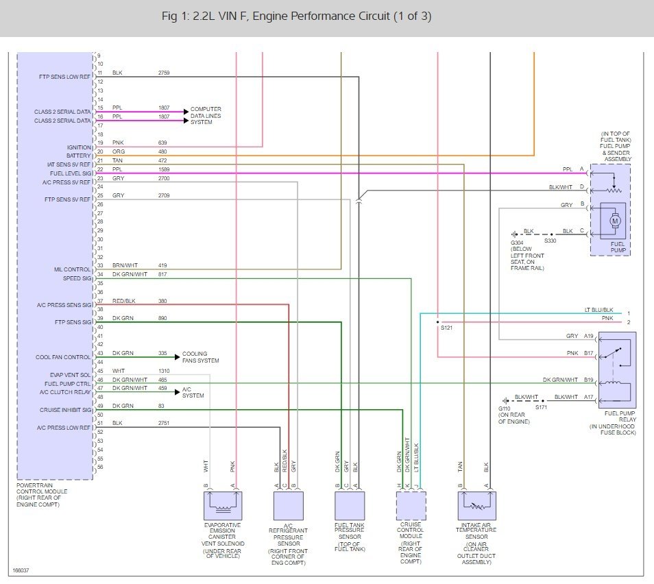

I'd like to know where the fuel pump reset switch is located
Jun 1, 2008 at 3:39 AM
  • 55,594 POSTS

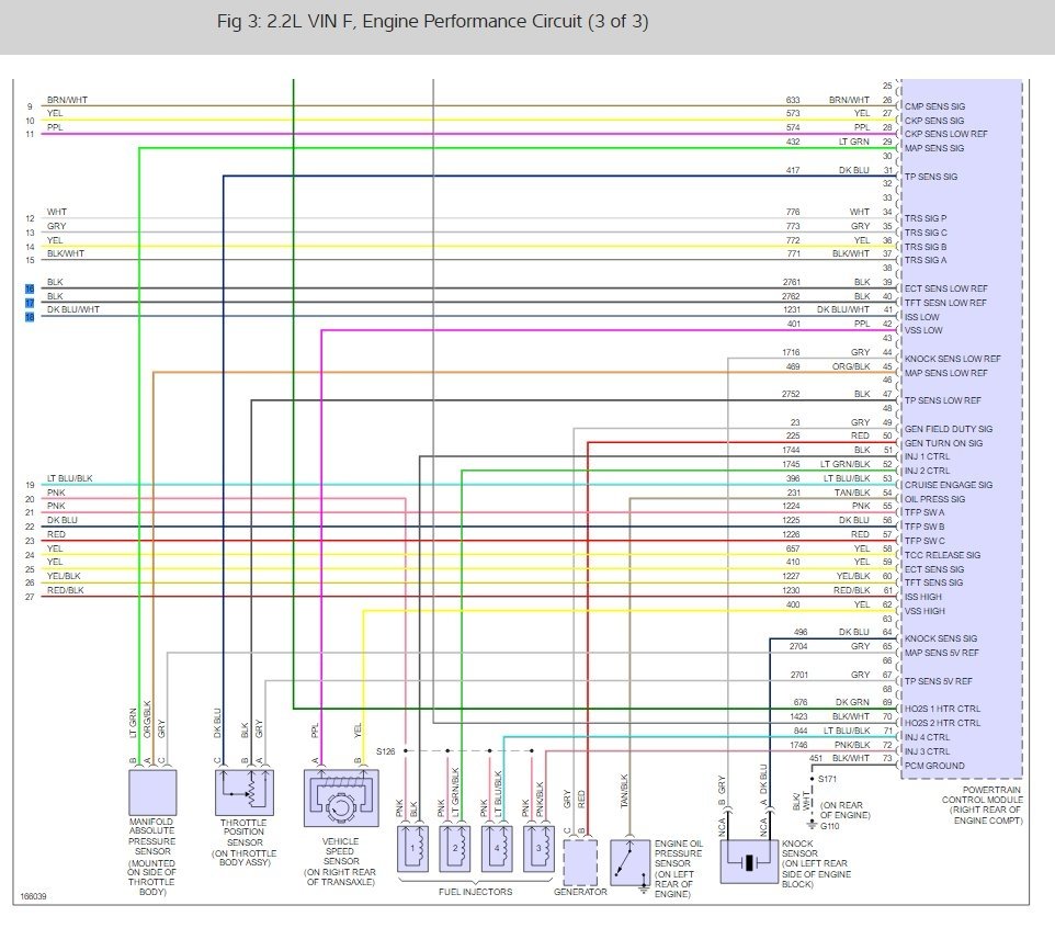

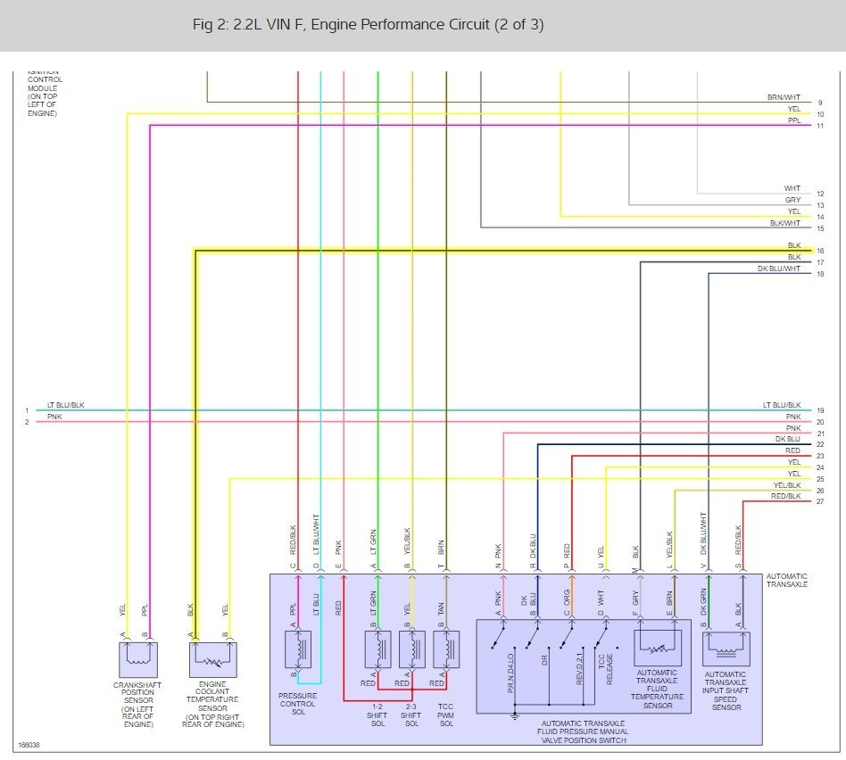

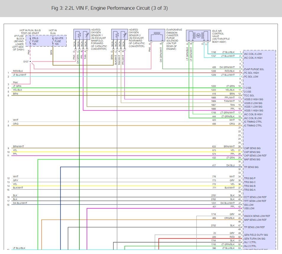

There is no fuel pump cutoff switch for this car. There is a fuel pump relay though, here are the engine wiring diagrams (below) so you can do some testing along with a guide to help you get the problem fixed.
https://www.2carpros.com/articles/how-to-check-an-electrical-relay-and-wiring-control-circuit';
and
It could be the fuel pump has gone out and needs replacement
https://www.2carpros.com/articles/how-to-replace-an-electric-fuel-pump

I just wanted to know where my fuel pump would be located?
Jun 1, 2017 at 5:46 AM (Merged)
  • 75,988 POSTS
Your fuel pump is in the fuel tank
