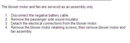

1995 Pontiac Sunfire 4 cyl Front Wheel Drive 160000 miles
I need to replace the blower moter on my car i am good with cars but have not done this before need to know how to get to it and replace it my car does not blow heat it doesn't blow any thing for that matter
Mar 3, 2010 at 4:29 AM
JDL
  • 16,098 POSTS
Hi, I check all applicable fuses. Use a testlite, make sure fuse circuits are hot. Take connector loose from blower, turn on the key, hvac controls, See if good voltage and ground at the connector, If that checks out, suspect the motor.
https://images.2carpros.com/forum/automotive_pictures/170934_sunfire_blower_motor_1.jpg
