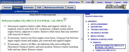

how do you remove the starter from 94 sunbird Le, 2l engine,. It looks like you have to go from under the car. It also looks like you have to take half the drive train off to get at it. am i missing something?

Mit1 .com removal procedures:
https://images.2carpros.com/forum/automotive_pictures/12900_starter_removal_2.jpg
