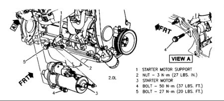

1994 Pontiac Sunbird starter
130,246 MILES • 4 CYL • FWD • AUTOMATIC
VICT7L
How to get to the starter to replace it.
Mar 14, 2010 at 11:59 PM
  • 75,988 POSTS
https://images.2carpros.com/forum/automotive_pictures/12900_sunbird_1.jpg
Automatic Transaxle Remove or Disconnect Negative battery cable at battery. Upper starter bolt. Raise vehicle. Starter electrical connectors. Engine ground cable at engine. Rear starter mount. Lower starter bolt. Starter. Install or Connect Starter. Lower starter bolt. Rear starter mount. Starter electrical connectors. Engine ground cable to engine. Lower vehicle. Upper starter bolt. Negative battery cable. https://www.2carpros.com/kpages/auto_repair_manuals_alldata.htm
