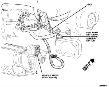

I've been using Fram products ever since they market it-my choice the orange can. Remove the fuel pump/oil pressure sending unit and install the gauge Normal Oil Pressure 65 psi Notes Rear Of Engine Compartment (Automatic)
https://images.2carpros.com/forum/automotive_pictures/12900_oil_pump_8.jpg
Lower RH front of Engine Compartment, below Electronic Ignition (EI) system
