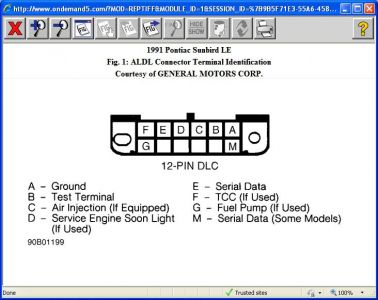

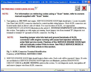

Not really sure whats going on. Just took my car to a mechanic and he says there is nothing wrong, all though driving home i noticed that the check engine light is coming back on when i turn left and when i turn on the air/heat. I know that light is coming on for some reason but i cant seem to find a straight answer

https://images.2carpros.com/forum/automotive_pictures/416332_1991_pontiac_sunbird_retriving_codes_part_1_1.jpg
https://images.2carpros.com/forum/automotive_pictures/416332_1991_pontiac_sunbird_retriving_codes_part_2_1.jpg
Try that it will tell you what code's you have.
