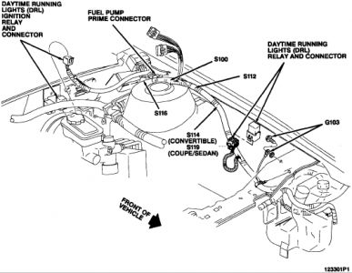

My daytime running lights stopped working. I checked the fuse and the e- brake is off.

Probable causes: could be the DRL module or the relays

Thank-you, but can you tell me, where the mondule & relays are. I know there's two relays on the inner fender on the drivers side, next to the battriey.

DRL module Behind LH side of Instrument Panel, near C200.
https://www.2carpros.com/forum/automotive_pictures/12900_drl_1.gif
Relays:
https://www.2carpros.com/forum/automotive_pictures/12900_drl1_1.jpg
