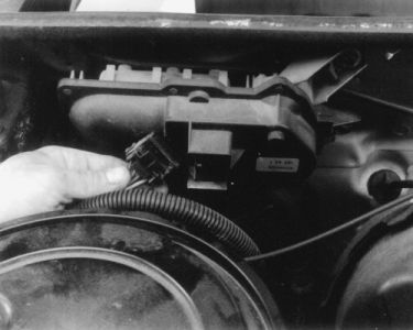

Okay, no problem. If you mean where to purchase the motor at, you can purchase it at most any auto part store. I researched them a little for you and found the average price to be around $65.00 including a core charge. The core charge (you giving them your broken motor) will be around $15.00 so the total will be around $40.00 after you give them your wiper motor. Wiper motor will be located under hood, near firewall, usually in between the two wipers. Instructions are listed below for removal and replacement. REMOVAL: Remove the wiper arm and blade assemblies. Disconnect the negative battery cable. Remove the shroud top vent grill. Tag and disconnect all electrical leads from the wiper motor. Detaching the electrical connector from the wiper motor - 1988 Sunbird shown
https://images.2carpros.com/forum/automotive_pictures/261618_0900c1528003bd16_1.jpg
Remove the drive link from the wiper motor crank arm. Remove wiper bolts, then remove the wiper motor assembly, guiding the crank arm through the hole. INSTALLATION: Guide the crank arm through the opening in the body and then tighten the mounting bolts to 80 inch lbs. (9 Nm). Install the drive link to the crank arm with the motor in the park position. Installation of the remaining components is the reverse of removal. Hope this helps.. Thanks for using 2carpros.com!
