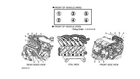

I Want to check that the spark plug wires are on the right spark plugs, and how to test the coil packs?
Jul 7, 2010 at 4:08 AM
INTERNETMECHANIC
  • 700 POSTS
My info showed this firing order for the 3.1, did you visually check for spark at the plugs? You can pull a spark plug wire, use known good plug or spark tester in the boot, ground metal part of plug/tester to metal part of engine. engine cranking, watch for spark. I wouldn't think all your coils would fail at the same time? Any applicable codes?
https://images.2carpros.com/forum/automotive_pictures/512072_pontiac_sunbird_31_1.jpg

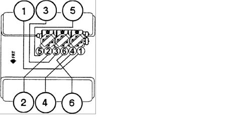

I got two or three databases I use, they all have mistakes. Maybe this is better.
https://images.2carpros.com/forum/automotive_pictures/512072_sunbird_31_1.jpg
