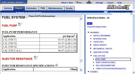

Sir-can you provide the fuel pressure readings. The injectors listen to it if its clicking, or use a noid lite to see if its getting power and get back to me.
Oct 22, 2008 at 7:35 AM
JQ
  • 6 POSTS
Alright, the fuel pressure at the schrader valve is consistently at 41psi. It seems to hold that preasure for a good amount of time following fuel pump prime. Also, I used a noid light to test the exposed injector...the light flickered as if the injector was to be properly working. I appreciate your help. Thank you.

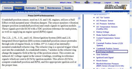

Test the crankshaft sensor resistance should read 900-1200 ohms. Also set the meter to AC 2 volt scale crank engine over reading should be .05volts slow cranking to 1.0volts at greater cranking speed
Oct 23, 2008 at 4:27 AM
JQ
  • 6 POSTS
I was told by the parts store and by a pontiac service tech that this car did not have a crank sensor...It has a camshaft position sensor. Can you tell me where the crank sensor is located and what I should be looking for? I assume it should be on the lower front of the engine if it has one? I appreciate your assistance. Thank you.

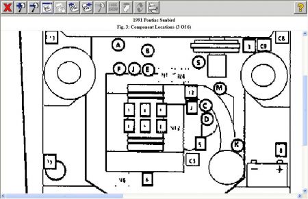

Sir-some auto references says it has a CPS and the software that am using says it has one for a 3.1 engine. Is this a direct ignition system-meaning don't have a distributor. and also is it VIN T engine? Try looking on the right side of the block below the exhaust manifold-see below pic location E
https://images.2carpros.com/forum/automotive_pictures/12900_cps2_3.jpg
https://images.2carpros.com/forum/automotive_pictures/12900_cps3_2.jpg
Oct 23, 2008 at 6:36 PM
JQ
  • 6 POSTS
Thank you for your assistance. This motor has a direct ignition. The sensor you reference as "E" is located against the block below the manifold near the knock sensor. This according to my parts store is the camshaft position sensor, but this is not a crank sensor? I've already replace the camshaft position sensor located at "E". I appologize for any confusion.

The CPS protrudes thru side of engine block to within .05 of an internally mounted crankshaft reluctor ring-
CPS -Also look under the DIS module

Sounds more like a fuel problem-check the fuel pressure with a fuel pressure gauge with and w/o the regulator-if okay, Look for injection pulses-meaning injector/s are opening and closing providing fuel.
BTW Do you hear the fuel pump come On for 2 secs?
