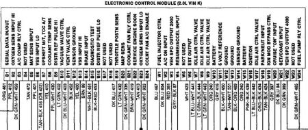

The plastic shrouds on the ignition control module disintigrated when the part was removed. Unfortunately, I did not mark which wire went to which prong. is there anywhere to fire a color diagram of which wire goes to which prong?
