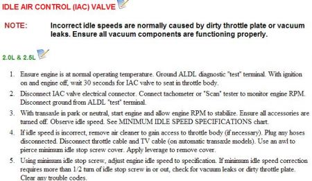

I bought the car for 300.00 so I know it will have problems and I am Ok that. The car Idles at around 3500 to 4500 RPM's in neutral so to play it safe I changed plugs,wires, rotor,and cap. No fix. looked for a vacum leak found a couple and fixed them ( one was a hose that
I could not find where it went so I pluged it) RPM came down to the speed in the beginning of this question. Could it be the IDLE AIR CONTROL VALVE. or could it be that and something more

Hi there, Do these checks & tests first. mark (mhpautos)
https://images.2carpros.com/forum/automotive_pictures/61395_1_58.jpg
