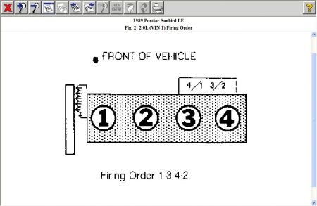

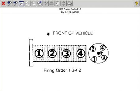

what is the firing order for a 1989 pontiac sunbird gt turbo
Jul 31, 2008 at 4:39 PM
  • 75,992 POSTS
See below
https://images.2carpros.com/forum/automotive_pictures/12900_fo1_2.jpg
https://images.2carpros.com/forum/automotive_pictures/12900_fo2_2.jpg
