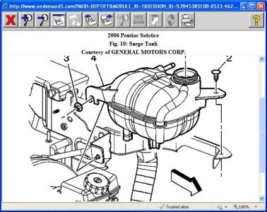

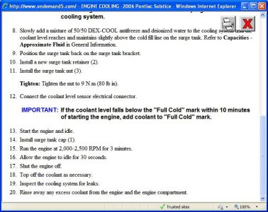

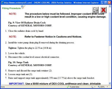

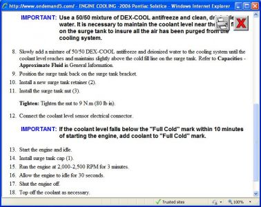

after changing the water pump i cannot get the cooling system to take antifreeze..How and what do i do to get it in?
Aug 13, 2010 at 9:33 PM
SATURNTECH9
  • 30,869 POSTS
https://images.2carpros.com/forum/automotive_pictures/416332_2006_pont_solstice_filling_the_coolant_part1_1.jpg
https://images.2carpros.com/forum/automotive_pictures/416332_2006_pont_solstice_filling_the_coolant_part2_1.jpg
https://images.2carpros.com/forum/automotive_pictures/416332_2006_pont_solstice_filling_the_coolant_part3_1.jpg
https://images.2carpros.com/forum/automotive_pictures/416332_2006_pont_solstice_filling_the_coolant_part4_1.jpg
There you go.
