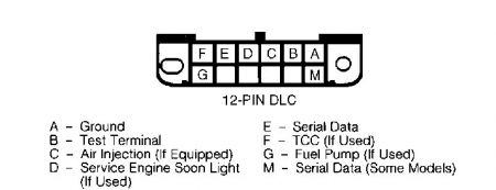

https://images.2carpros.com/forum/automotive_pictures/30961_obd2_2.jpg
Encuentre el DLC. ¿parece el conector DLC al cuadro? O
https://images.2carpros.com/forum/automotive_pictures/30961_firdlc_1.jpg
Posición de DLC
https://images.2carpros.com/forum/automotive_pictures/30961_dlc_loc_1.jpg

I was trying to help the communications. You have an older plug that will not accept the OBD 2 connector. The plug must look like your connector.
Yo trataba de ayudar a las comunicaciones. Usted tiene un enchufe más viejo que no aceptará el OBD 2 conector. El enchufe debe parecer a su conector

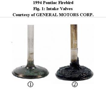

Necesito los códigos en la computadora o adivinamos.
Intente este:
Usted limpia
https://www.2carpros.com/dia/index.htm
I need the codes in the computer or adivinamos.
Try this one:
You clean
https://www.2carpros.com/forum/automotive_pictures/30961_intake_valves_1.jpg
https://www.2carpros.com/how_to/how_to_tune_up.htm

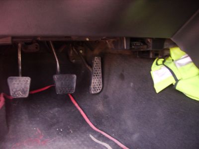

thank you very much. Sight I am going to try that they let a camera to me of photos to do a photo to him to my connector ok?

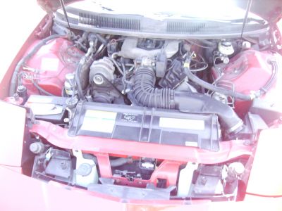

REGGAEMAN
  • 17 POSTS
https://images.2carpros.com/forum/automotive_pictures/73364_IMG_0002_1.jpg
it arrives at the right next to the pedal sees the Connector.
May 21, 2007 at 8:27 AM
REGGAEMAN
  • 17 POSTS
After leaving the car the factory, after making change of oil and filters light SERVICE ENGINE SOON no longer ignites but it has symptoms such. When I take the perfect car in the morning the first 15 minutes but later it is extinguished when it wants gives pulls, not that to do. Here down you have a photo of the motor but it is of little aid.
https://images.2carpros.com/forum/automotive_pictures/73364_IMG_0003_1.jpg
May 21, 2007 at 8:54 AM

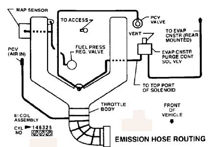

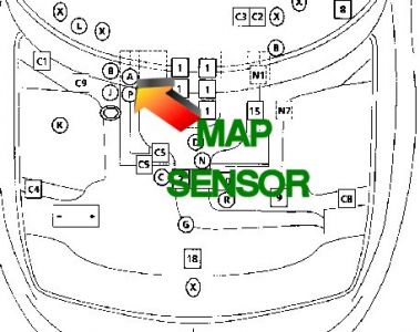

  • 9,123 POSTS

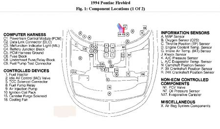

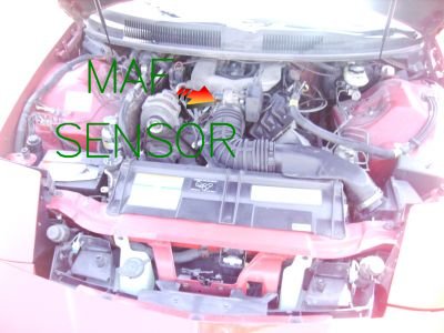

You can try unplugging the MAF sensor and driving the car, or unplugging the MAP sensor and driving the car. Usted puede tratar de desenchufar el sensor MAF y conducir el coche, o desenchufar el sensor de MAPA y conducir el coche.
https://images.2carpros.com/forum/automotive_pictures/30961_mafpon_1.jpg
https://images.2carpros.com/forum/automotive_pictures/30961_mappon_1.jpg

Good proven the one of the sensor the car goes well but all the accelerated short while to two thousand revolutions remains. All the short while accelerated to 2000

  • 9,123 POSTS
https://images.2carpros.com/forum/automotive_pictures/30961_firebirdvac_1.jpg
need good vacuum. necesite el vacío bueno. did the sensor get replaced? Was the sensor bad? Which one? ¿se hizo el sensor sustituido? ¿Era el sensor mal? ¿Cuál?

The sensor that you showed to me in the previous photo, disconnects it, and when it takes the car it was accelerated to 2000 revolutions.
May 29, 2007 at 10:27 PM
SERVICE WRITER
  • 9,123 POSTS
disconnected the maf sensor?
electronically?, with the electrical connector correct?
Clean the sensor
¿desconectado el sensor maf?
¿electrónicamente? ¿, con el conector eléctrico correcto?
Limpie el sensor.
