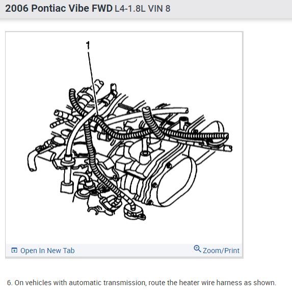

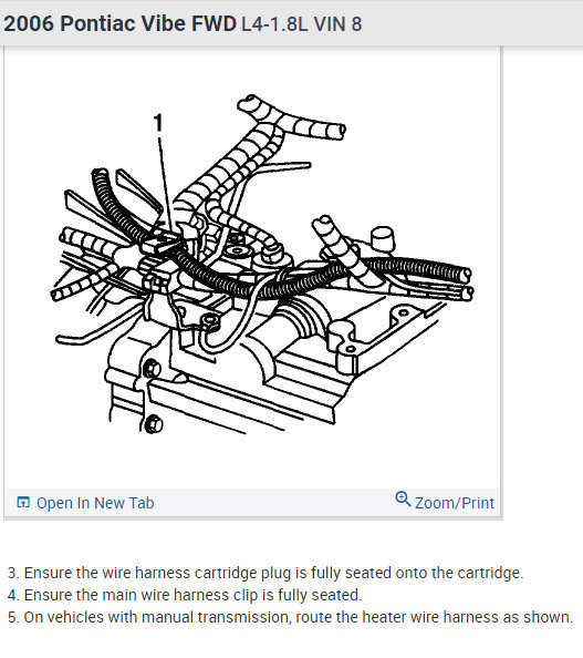

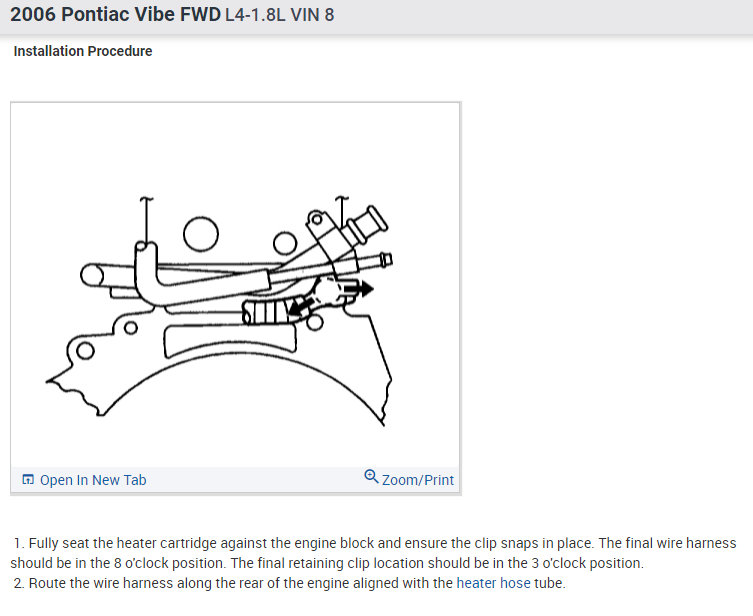

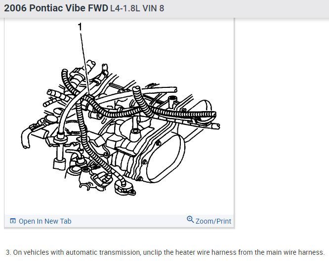

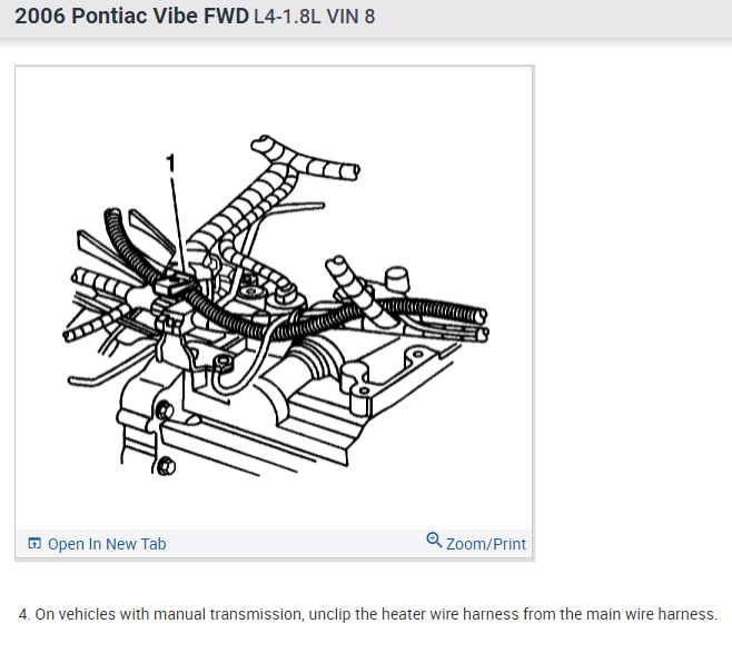

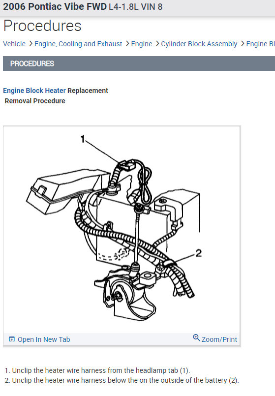

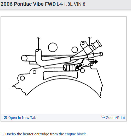

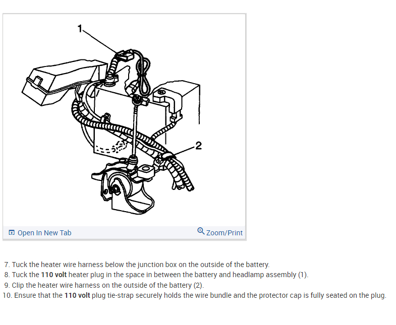

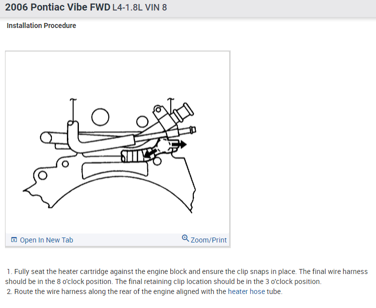

I have a 2006 pontiac vibe and i was wanting to know where exactly the heater element goes on the engine block when you plug it in the winter and what exactly i have to take off the engine, it already cost me 110 bucks for the heater element and it will cost 150 more if someone does it and i dont have that kind of money. Please help me.
Sep 23, 2008 at 2:28 PM
SQM
  • 6,383 POSTS
The factory block heater goes to the back of the engine (firewall side) towards the bottom.
You will have to remove a there is a plate that have to be removed in order to install the heater element.
I have included the installation instruction for the factory style block heater for your vehicle.
