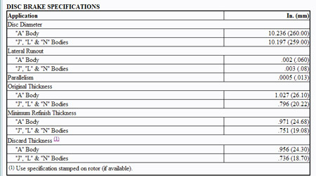

Would you be able to tell me what the minimum thickness required to re-lathe/turn the rotors? I know how to replace them just cant remember minimum thickness allowed before having to replace them all togeher. The imprint on them is too rusted to see.

I would need to know what car model to look up, but generally speaking, rotors today are as cheap as turning them, My local parts store no longer turns rotors!

Answer to PM:From: YAKK420 To: merlin2021 Posted: Fri Mar 21, 2008 4:38 pm Subject: rotors Would you be able to tell me what the minimum thickness required to re-lathe/turn the rotors? I know how to replace them just cant remember minimum thickness allowed before having to replace them all togeher. The imprint on them is too rusted to see. ITS A 93 OLDS. CULASS SUPREME. Here's the chart...
https://images.2carpros.com/forum/automotive_pictures/62217_Rotor_Specs_2.jpg
