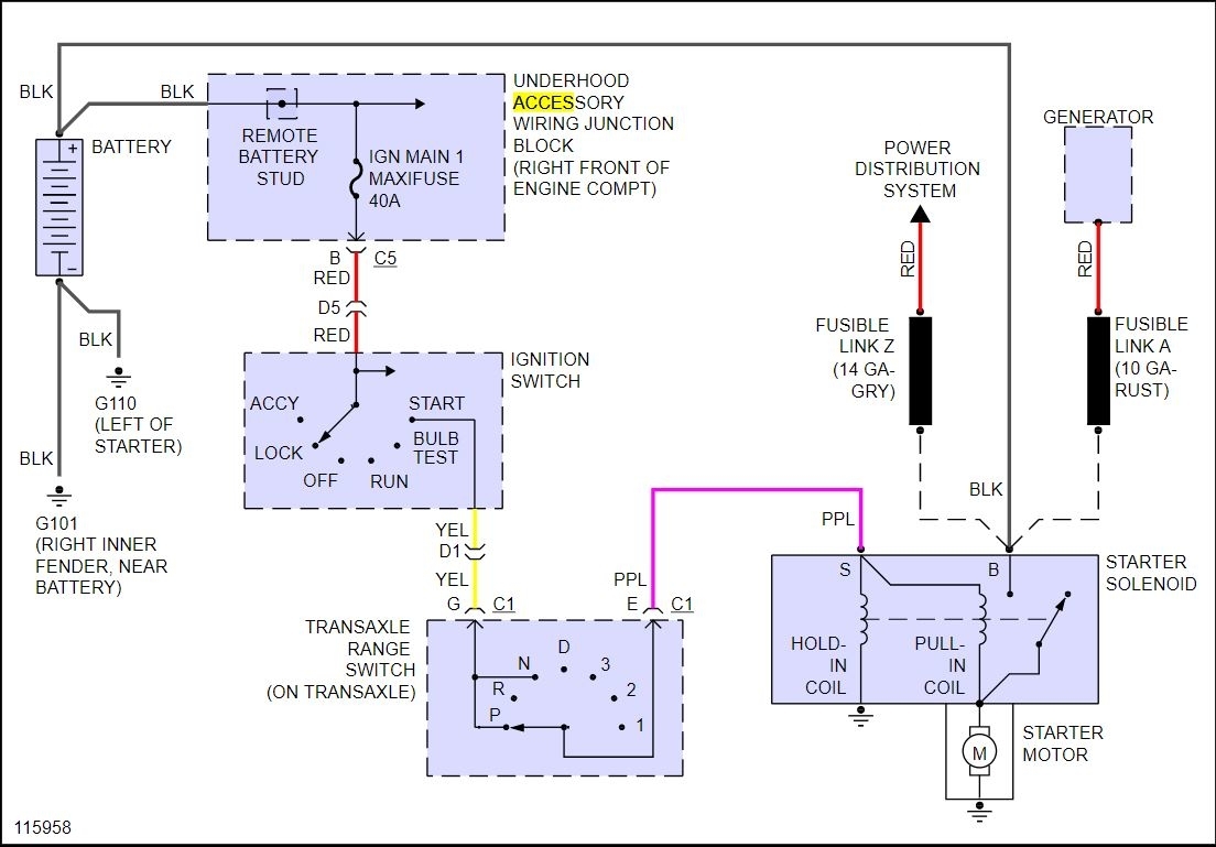

We tried to start it with the old battery and it would not start. We jumped it and it worked fine until we parked it. Then it did not start again. We replaced the battery and now even a jump start will not make it run. It will not even crank. The people at AutoZone said they tested the alternator and starter and said they were good.

So AutoZone bench tested the starter or did they test on still on the vehicle?
Make sure the IGN Main 1 maxi fuse in the under hood junction block, located under the hood right side is not blown.
