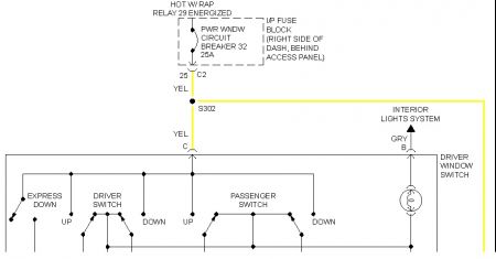

Any applicable fuses, did you check for voltage at the fuse circuit, use a voltage tester. Any voltage at the power window circuit breaker?
https://images.2carpros.com/forum/automotive_pictures/170934_montana_power_windows_1.jpg

You are so kind to respond back. I am here with my father who was a mechanic when he came home from WWII. He is determined that we are going to fix this while he is visiting. He does not understand the electronics and to be completely honest neither do I. He really wants to help me do this. I have a small voltage tester that lights up that we have used to test the fuses. When we pulled the power window circuit out, their was no voltage in that slot. Does that make any sense. My light did not light up when I put it into the hole. thank you for all your help. Now what?

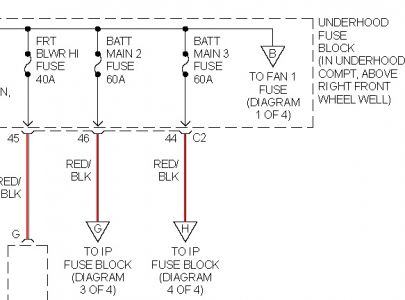

  • 16,098 POSTS
Did you test it with the key on? My info says it gets voltage from the rap relay. Also, check bat 3 main fuse for voltage.
https://images.2carpros.com/forum/automotive_pictures/170934_bat_3_main_fuse_1.jpg

Nov 9, 2010 at 11:33 AM
ALUDLAM
  • 5 POSTS
BAT 3 -- every time I put my tester to the fuse, the light came on .... on further inspection the fuse is "broken", but I was pushing the two sides together with the tester and getting a connection. Does that make sense? I'm headed to the store to get another fuse. Do you think that it was the real problem, or just a symptom of something bigger?
