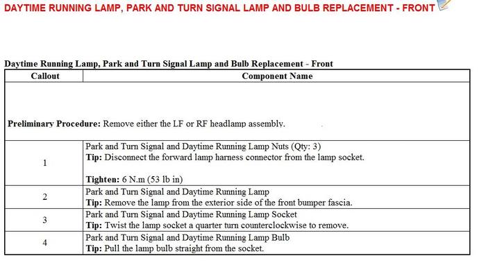

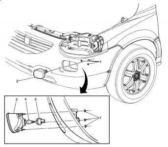

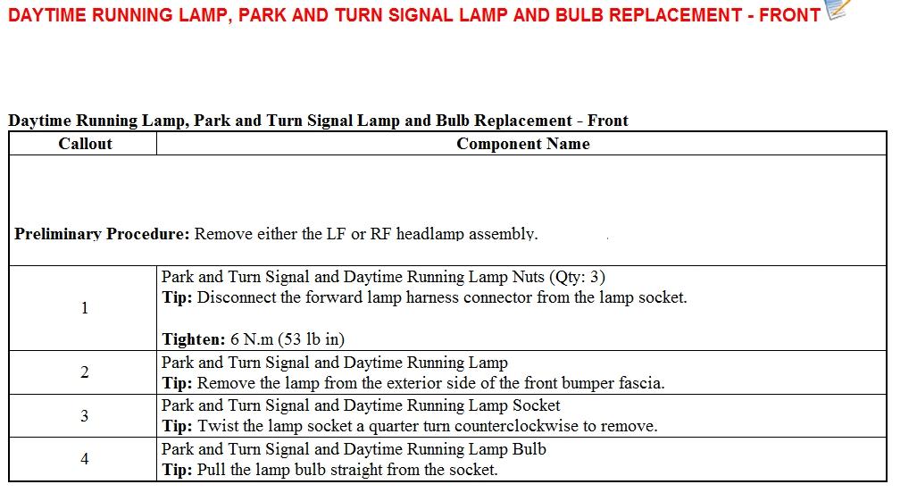

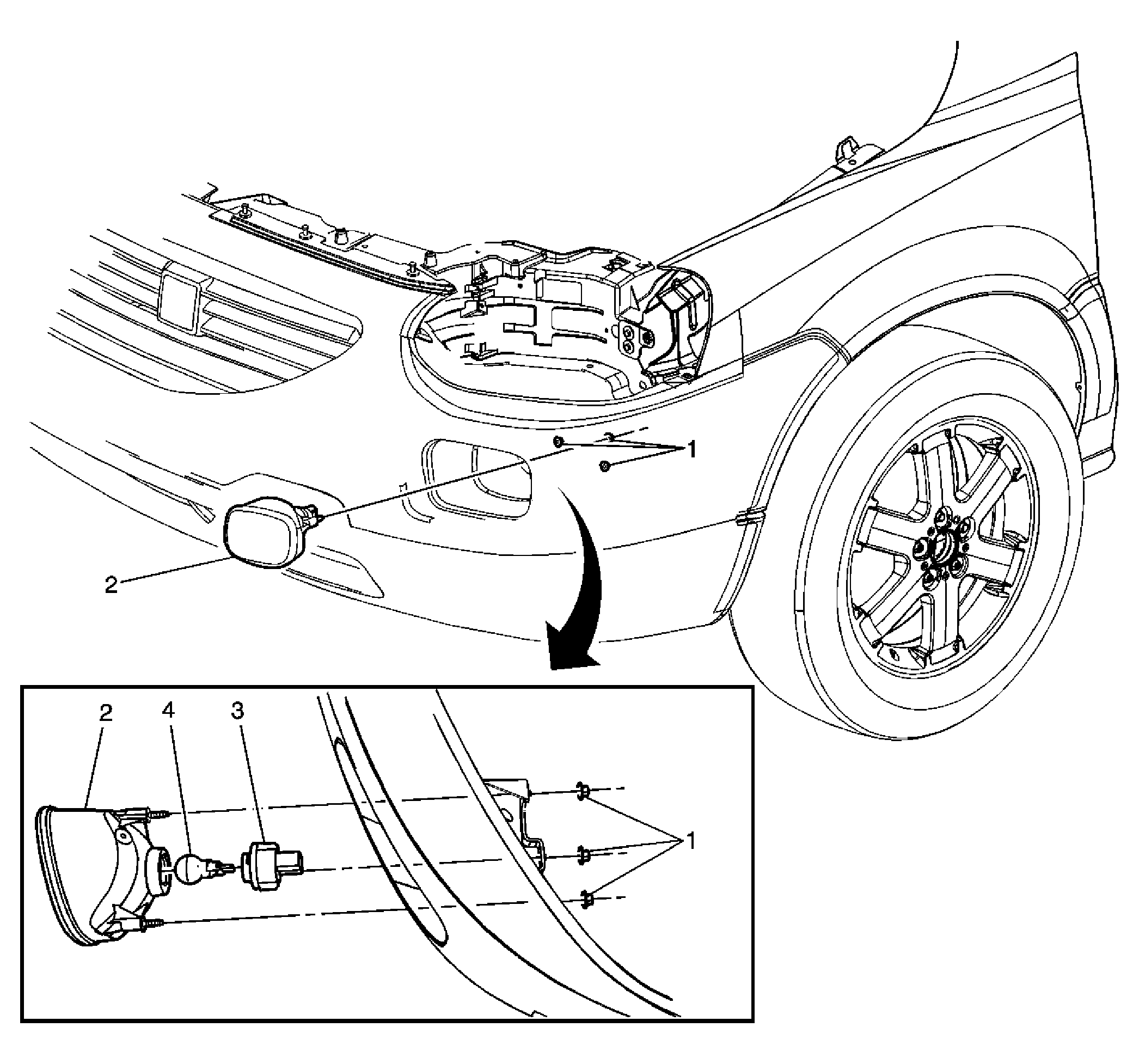

ASISLER
How do I change the passenger side turn signal bulb? I have removed the screw and retaining rod, but I cannot get the housing to release from the body. Help.
Jul 3, 2018 at 1:59 PM (Merged)
FACTORYJACK
  • 4,159 POSTS
Here is what I have from service information.

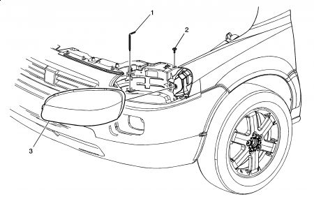

https://images.2carpros.com/forum/automotive_pictures/309872_313854_1.jpg
Parking, Front Side Marker, and Turn Signal Lamp Replacement Removal Procedure Open and support the hood. Remove the wing nut from the headlamp bracket. Remove the front park/turn signal/sidemarker lamp from the fender. Press the tab while turning counterclockwise to remove the bulb socket from the front park/turn signal/sidemarker lamp. Pull the bulb from the socket. Installation Procedure Press the bulb into the socket. Install the socket to the front park/turn signal/sidemarker lamp. Position the front park/turn signal/sidemarker lamp to the fender: 3.1. Locate the tabs into the fender. 3.2. Install the tab into the headlamp bracket. Install the wing nut to headlamp bracket and hand tighten. If this is an SV6 Montana, it looks like the procedure is different, here is its procedure.

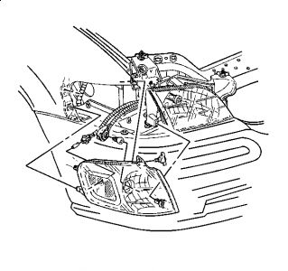

https://images.2carpros.com/forum/automotive_pictures/309872_1547141_2.jpg
Headlamp Assembly or Headlamp Bulb Replacement Callout Component Name Notice: Refer to Fastener Notice in the Preface section. Fastener Tightening Specifications: Refer to Fastener Tightening Specifications . Headlamp Replacement 1 Pin, Headlamp Mounting Panel (Qty: 2) 2 Bolt, Headlamp Mounting Panel (Qty: 2) Tighten 12 N ·m (106 lb in) 3 Headlamp Assembly (Qty: 2) Tip Pull the headlamp forward to disengage the ball and socket attachment at the rear of the headlamp. Disconnect the electrical connector. Remove and replace the bulbs if necessary. Remove and replace the headlamp wiring harness if necessary.
https://images.2carpros.com/forum/automotive_pictures/309872_1506227_1.jpg
Daytime Running Lamp, Park and Turn Signal Lamp and Bulb Replacement - Front Callout Component Name Notice: Refer to Fastener Notice in the Preface section. Fastener Tightening Specifications: Refer to Fastener Tightening Specifications . Preliminary Procedure Remove either the LF or RF headlamp assembly. Refer to Headlamp Assembly or Headlamp Bulb Replacement . 1 Park and Turn Signal and Daytime Running Lamp Nuts (Qty: 3) Tip Disconnect the forward lamp harness connector from the lamp socket. Tighten 6 N ·m (53 lb in) 2 Park and Turn Signal and Daytime Running Lamp Tip Remove the lamp from the exterior side of the front bumper fascia. 3 Park and Turn Signal and Daytime Running Lamp Socket Tip Twist the lamp socket a quarter turn counterclockwise to remove. 4 Park and Turn Signal and Daytime Running Lamp Bulb Tip Pull the lamp bulb straight from the socket.
