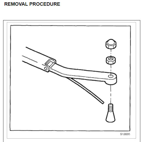

SATURNTECH9
  • 30,869 POSTS
Take a garden hose and spray it at the windshield you will be able to see the water leak which will probably need to reseal the entire windshield which means replacement. Here is how you remove the wiper arms.
Pull upward on the arm while tapping on the pivot shaft.
Cheers
+1

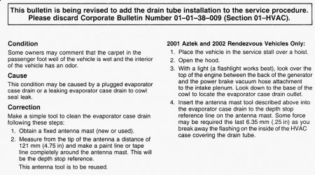

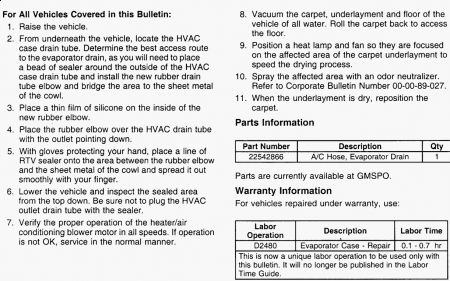

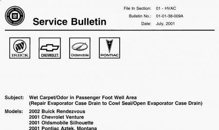

MERLIN2021
  • 17,250 POSTS
There is a bulliten out on the a/c drain, but the passenger side floor will be wet? Here's the bulliten:
https://www.2carpros.com/forum/automotive_pictures/62217_ma_1.jpg
https://www.2carpros.com/forum/automotive_pictures/62217_mb_1.jpg
https://www.2carpros.com/forum/automotive_pictures/62217_mc_1.jpg
