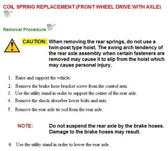

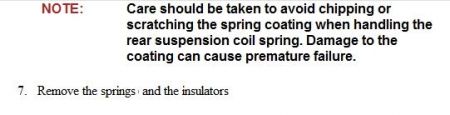

I need to remove the rear coil springs to install an air lift kit. Problem is this car is very difficult to fit a spring compression tool in. So far I have not found one that fits. What is the secret to getting these springs out?

https://images.2carpros.com/forum/automotive_pictures/261618_Noname_1872.jpg
https://images.2carpros.com/forum/automotive_pictures/261618_Noname2_598.jpg
