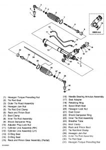

Your response said to check the CV joints for the clicking, however this is a very definite different type of clicking. I have had clicking CV joints in the past on other vehicles, so know the difference. I also had the CV joints recently checked and they were given a clean bill of health. Furthermore, the rapid clicking is random, regardless of on a straightaway or turning, driving fast or slow. This is definitely coming from the steering wheel or somewhere nearby. Please readvise!
Regarding the horn, when it sounds at random, nothing else happens. It just gives one good length blast. No locks changing, no repeat.....very wierd!

Raise car, put on stands, grasp each tire and push/pull both horizontally and vertically, looking for any movement which would indicate bearing, ball joint, tie rod end or bushing problem. Check rotors and calipers and pads for unusual wear and make sure calipers are torqued properly. If OK, then check that steering rack is securily bolted to frame. Also check PS pump fluid level and contidion of serpentine belt. Check PS pressure and return line for leaks. Check cinch bolt connection to steering rack. Rack:
https://images.2carpros.com/forum/automotive_pictures/108325_rack_2.jpg
