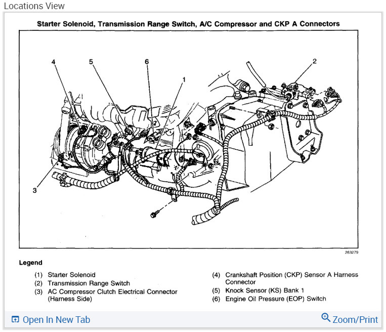

My wifes vehicle stalls out when you drive sometimes. Will Idle perfectly and some times run well. have replaced fuel pump and fuel filter.when it stalls its like it is starving for fuel.

This sounds like a classic crankshaft angle sensor that is going bed here is a guid to help you see step by step what to do with a diagram below to show you on your car.
this guide can help as well
Cheers

Engine wants to stall when throttling, will idle fine. no codes present on vehicle.no fuel smell.plugs were changed about 6 months ago,new wires also.doe,s not stall completely out more like a hesitating condition under load.

Thanks for this post I got a new crankshaft sensor for $76.00 never had the problem again I love this site.
