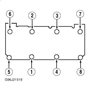

I would like to know what the torquing of the head bolts is?
I think it might be 110 what do you think???
Mar 3, 2010 at 10:27 AM
BLUELIGHTNIN6
  • 16,542 POSTS
you need NEW head bolts and be sure to apply sealant to the head bolts first. they tighten to 44 ft. lbs. and follow the sequence below. after tightening to 44 ft. lbs. they go an additional 95 degrees using a torque angle meter.
