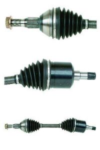

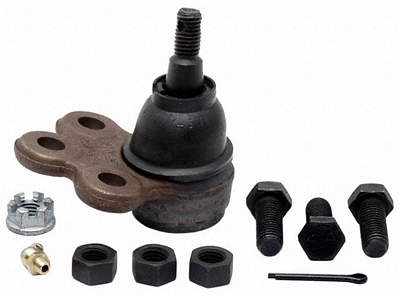

what is the difference between the ball joint and the cv joint.
Dec 18, 2008 at 6:01 AM
ZACKMAN
  • 4,202 POSTS
Ball joint is a part of suspension attaching your control arm to the steering knuckle, and CV joint is attaching the transaxle to the wheel hub. Here is to illustrate: Ball joint
https://images.2carpros.com/forum/automotive_pictures/55316_fa21744_1.jpg
and your CV joint
https://images.2carpros.com/forum/automotive_pictures/55316_661250_1.jpg
