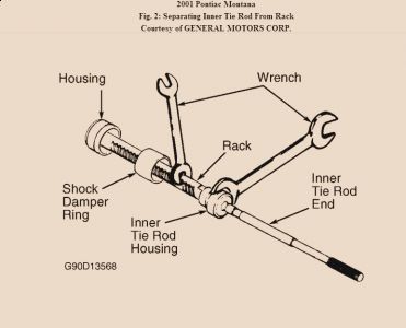

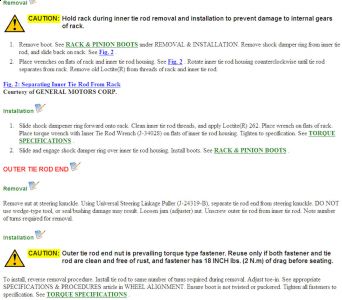

Can you explain the procedure to R & R the front passenger side Tie Rod End, and will I need a special tool to do the job?
